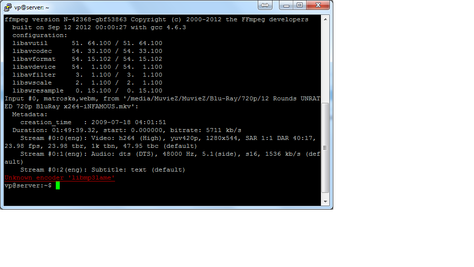

I ran it in the terminal and got an error : Unknown encoder 'libmp3lame'.
Any idea how to fix this
attached is the full discription
Post Thu Sep 13, 2012 6:32 pm
Re: Stream not found
OK, so the problem is that you don't have the proper version of ffmpeg, on need to add the "libmp3lame" library.
If you read : http://www.serviio.org/download
This release includes FFmpeg compiled using this source code, libRTMP 2.4 compiled using this source code and Lame MP3 Encoder (v. 3.98) compiled using this source code.
I'm not a linux specialist, so don't really know how to compile ffmpeg with these library...
Try with that : http://wiki.serviio.org/doku.php?id=build_ffmpeg_linux
thecoremc
Joined: Tue Sep 11, 2012 9:38 pm
Location: South Africa
Post Thu Sep 13, 2012 7:48 pm
Thank you so much. It's working now. I have done this before but didn't notice the HUGE red stop sign saying only a certain FFmpeg version works for serviio :
(This guide uses latest FFmpeg source, Serviio is tailored to work with a certain version though - the source can be downloaded at http://www.serviio.org/download) :roll:
and also when I compiled it earlier I only used ./configure instead of : :mrgreen:
./configure --enable-gpl --enable-libfaac --enable-libmp3lame --enable-libopencore-amrnb \
--enable-libopencore-amrwb --enable-libtheora --enable-libvorbis --enable-libx264 \
--enable-nonfree --enable-postproc --enable-version3 --enable-x11grab --enable-libvpx \
--enable-librtmp --enable-libxvid
Once again thank you for your patience and guidance through this issue.
