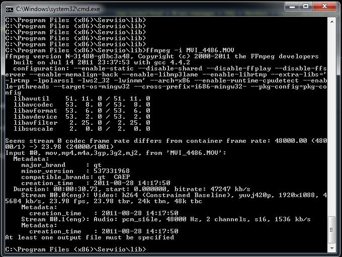

Also I am attaching a screenshot of ffmpeg output and the serviio.log with DEBUG enabled. The file that I am trying to watch from my TV is called MVI_4486.MOV
I am getting the message "wrong video codec" on my TV.

I tried your suggestion of transcoding the video offline and strangely enough I can see the generated file on my tv! One strange thing are the error messages I got from ffmpeg. Here is the log I captured;
ffmpeg.log
(9.11 KiB) Downloaded 720 times
The errors are:
1) Incompatible pixel format 'yuvj420p' for codec 'mpeg2video', auto-selecting form at 'yuv420p'
2) [ac3 @ 03a16100] channel_layout not specified
[ac3 @ 03a16100] No channel layout specified. The encoder will guess the layout,
but it might be incorrect.
Anyways it seems to work in the offline mode. Any suggestions on how to do it online, i.e., not having to transcode all my movies on my hard drive to be able to watch them on my tv?
