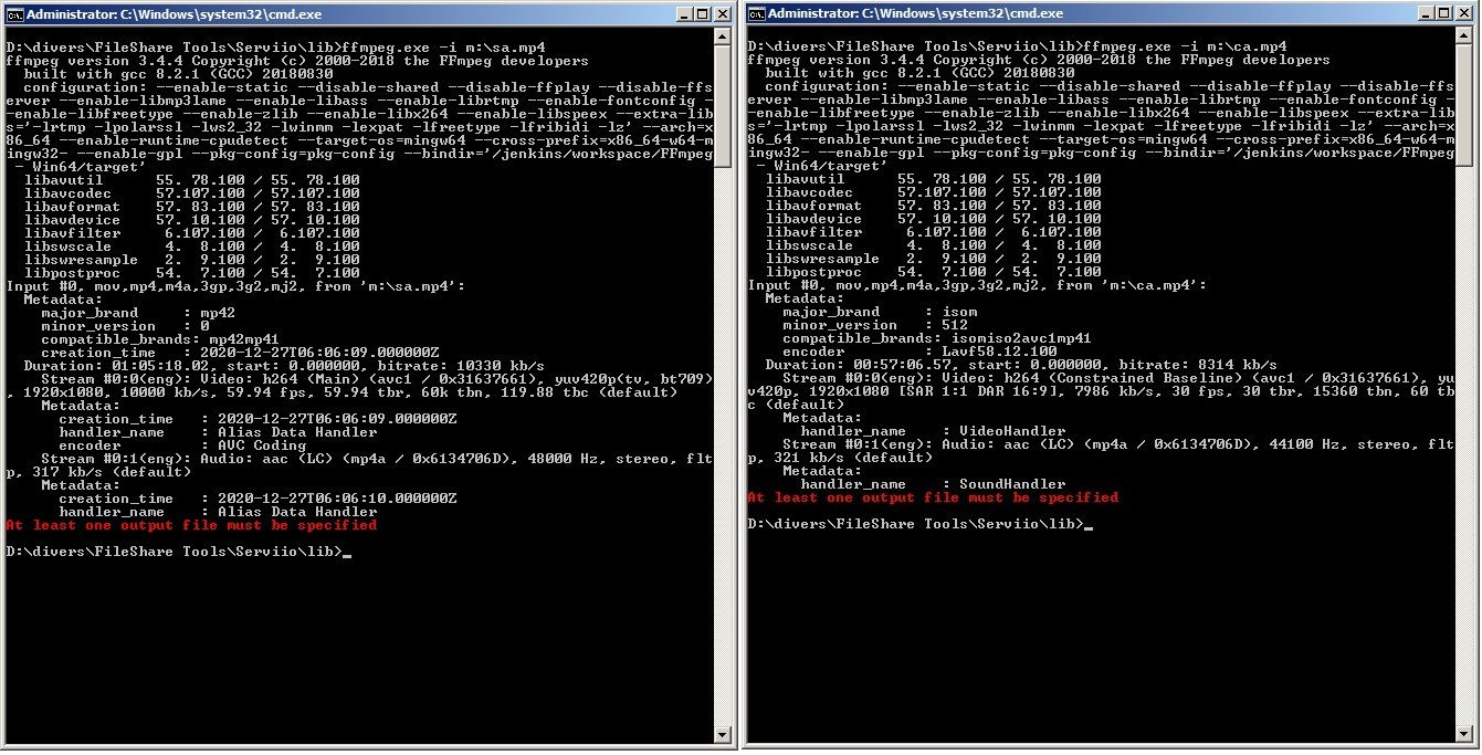

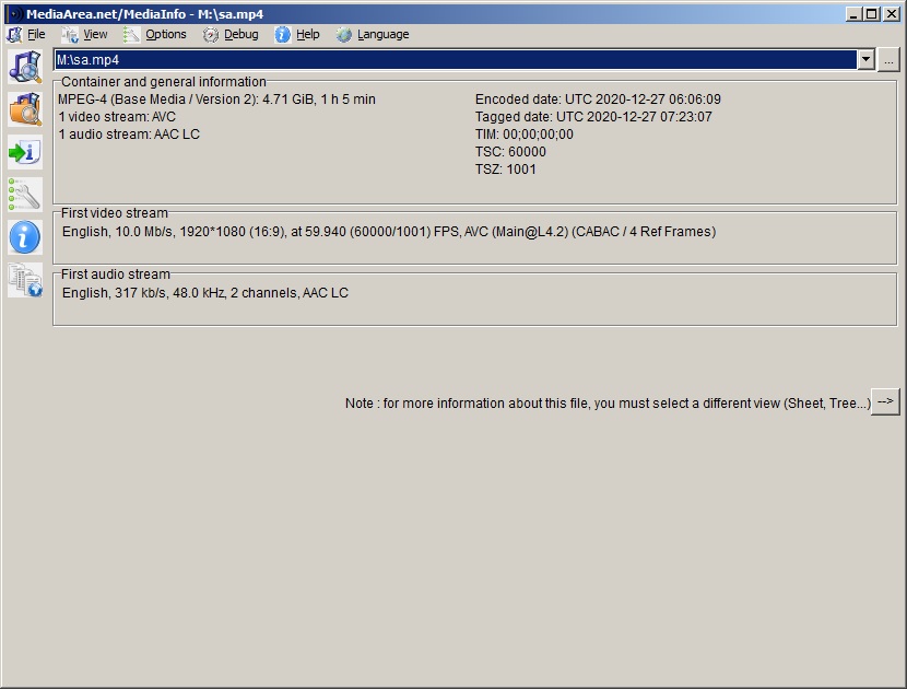

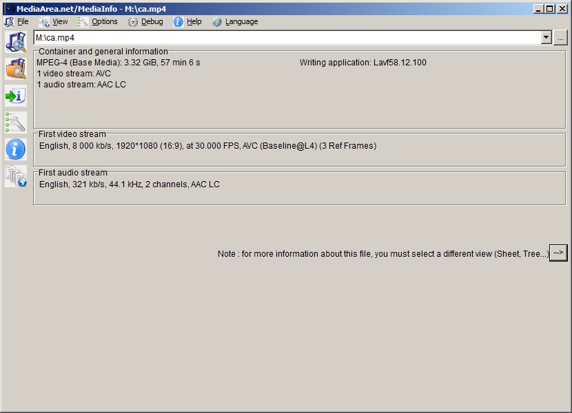

I recently I downloaded a same type op MP4 file from the same type of content from the same contentcreator which for some reason does play on the Samsung UE46F8000 so I have made a FFMPEG.exe -i and MediaInfo. I will post those results to.
MediafileInfoSaMP4.jpg is from the MP4 file / type of file that WONT play on the Samsung UE46F8000
MediafileinfoCAMP4.jpg is from the MP4 file of the same content/contentcreator that does work on the Samsung UE46F8000
FFMPEGSACAMP4.jpg is from both files. On the left you see the FFMPEG -i of the SA.mp4 file / type of file that WONT play on the Samsung UE46F8000, on the right you see the FFMPEG -i of the CA.mp4 file which is the MP4 file from the same content/contentcreator that does work on the Samsung UE46F8000

The FFMPEG screenshots are both the same file (ca.mp4), so that doesn't help ;) .
The MediaInfo does show a slight difference between the two AVC video codecs, in that one is baseline L4, while the one that doesn't play is L4.2. And that's probably the cause. I looked on the TV manual online, but it's not really specific about what levels of H.264 it supports.

atc98092 wrote:The FFMPEG screenshots are both the same file (ca.mp4), so that doesn't help ;) .
work.
Dear Dan,
Sorry about that, I was in a rush this morning so I apparently did not edit the file correctly.
I have reedited it correctly and uploaded it.
Hope that it helps!

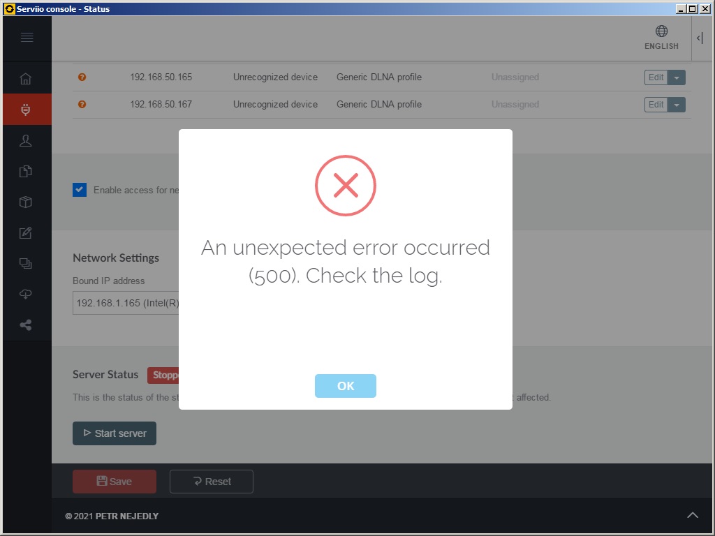

I did as you asked. I started notepad, copied your supplied information, saved it. Stopped Serviio, Started Serviio again.
But when I now try to start Serviio again I get an Error. (Unexpected Error occured 500 check log)
Il add the XML file I made, a screenshot of the Error and the Serviio logfile. Hope you can make sense of it.
The error only occurs when Serviio tries to load the the user.profiles.xml file, when I rename or remove that file I can start Serviio without a problem

I'm sorry. I see I made a typo. :oops: On the Matches line, after profile=, it's supposed to be a quote " but it's a parenthesis ' . Please change that and try loading it again. That should do it.

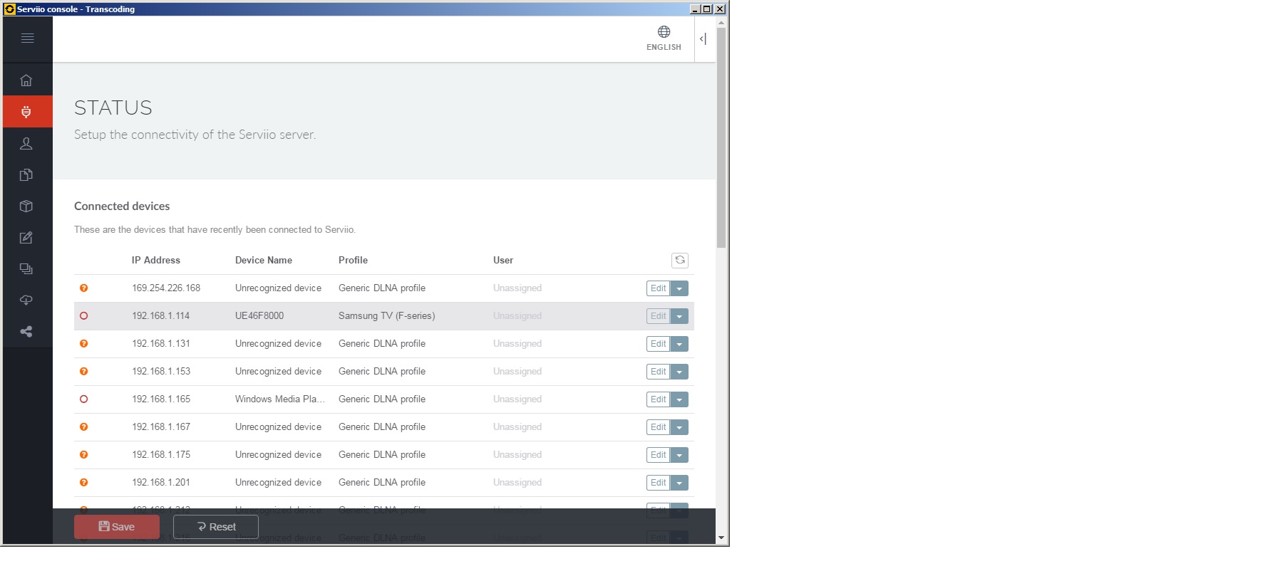

I have selected the Samsung F series profile and tried to load the MP4 file but I still get the same error message.
Serviio does not seem to Transcode anything.
When I look @ the Serviio Transcode folder I do not see any Transcoded files.
I will post a screenshit of the Serviio Status Window and I will also post the Serviio.log file.

Post Sun Feb 28, 2021 8:05 pm
Re: Samsung UE46F8000 transcoding MP4 to MKV profile HELP!
Well, I'm at a loss now. I've never played much with matching H.264 profiles, so maybe I have something wrong there. Hopefully someone with better knowledge can help out now. I'd hate to tell it to transcode all MP4 files, just to catch this one type.
