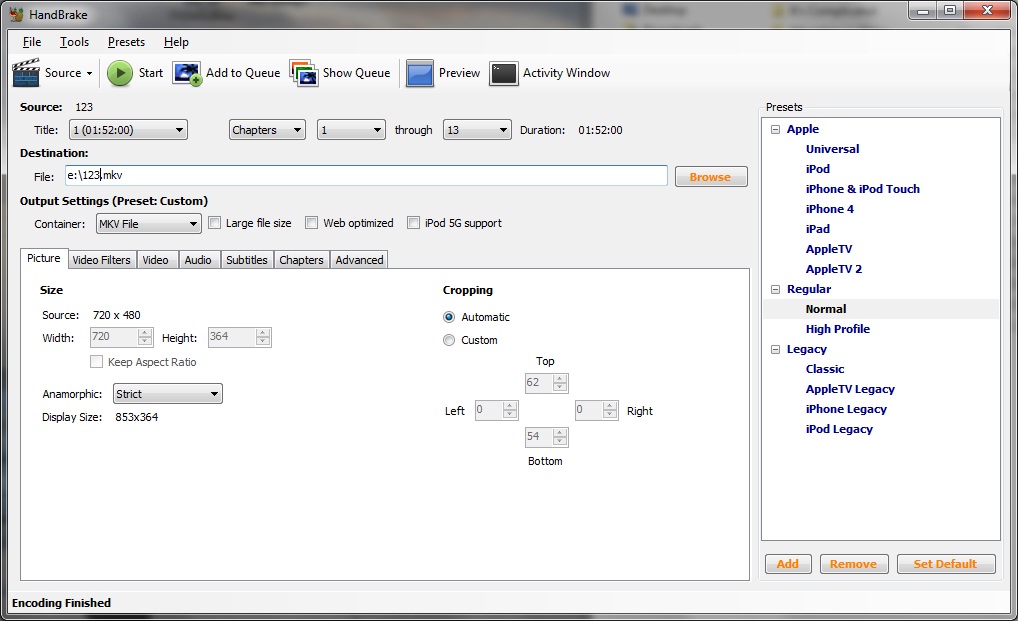

Post Wed Apr 20, 2011 7:28 am
Re: DVD to MKV using Handbrake

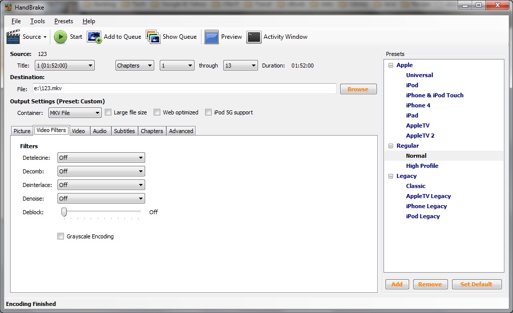

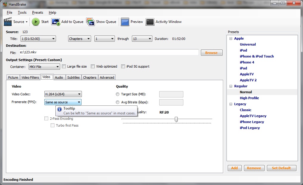

moltra wrote:Post screen shots or your handbrake setup or send me a PM and I will send you the profile that I use.
Here it is, thank you
Video setting
Video Filters setting
Video Filters.jpg (122.07 KiB) Viewed 39390 times
Picture setting
Joooom

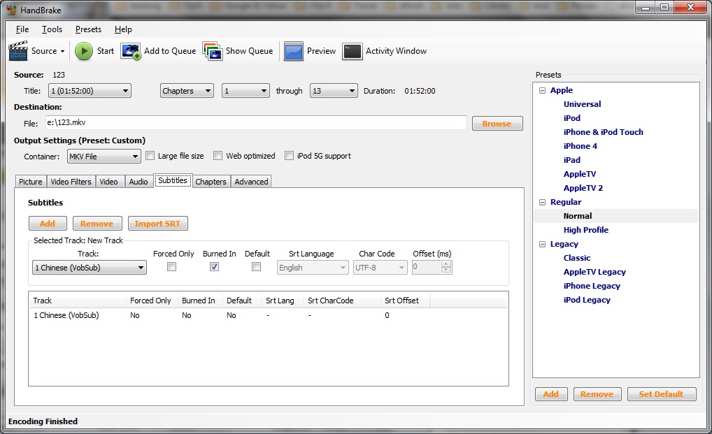

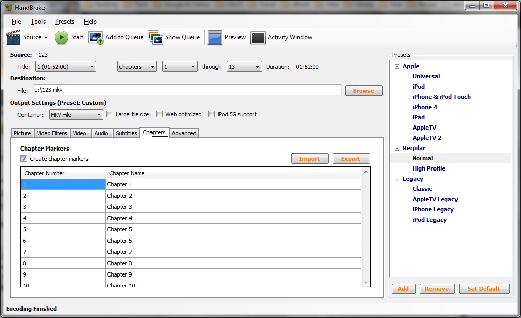

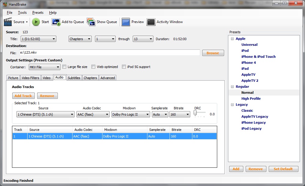

more screen shots
Chapters setting
Subtitles setting
Audio setting

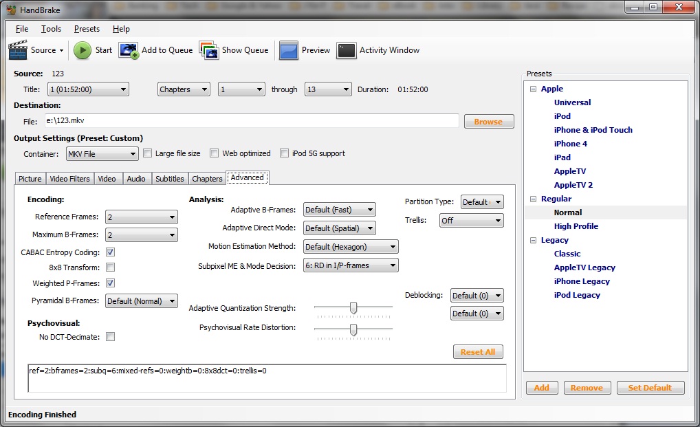

last screen shot
Advanced setting
