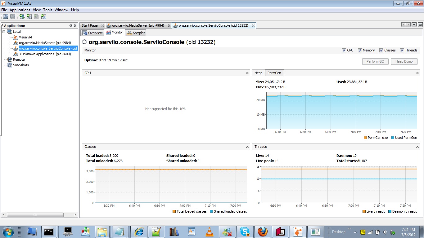

After running clean for 34 hours it hung again when beginning to parse a groovy (the same groovy successfully parsed 13 minutes earlier) and the systray console icon will not terminate Serviio. The cpuload from serviio however is 0. The heap size for the console is only using 50% of the allocated 9 megs and the Permgen whatever that is, is at 99.9% of the allocated 24 megs.
I've now restarted Serviio using the bats instead of the exe in order to monitor its heap size. At startup Serviio sawtoothed between 13 and 19 million of the 21million heap bytes. When it went to 21 million the heap size jumped to 23 Million. I'll leave VisualVM running.

ok, you're running out og permgen space. Try to add this to the vmoptions file
-XX:MaxPermSize=128m
Post Tue Mar 06, 2012 5:35 pm
Re: How do we debug this?
The max permgen for both the console and service is 85megs and I'm no where near that so I don't think that is the problem. Java is changing the allocated as required to meet the actual permgen and heap.
Currently the only vm option is -Xmx384m for the service which I assume you provided with the install, and that sets the max for the server heap which is only 29megs now.
Post Tue Mar 06, 2012 8:49 pm
This tells me you're running out or permgen
Post Wed Mar 07, 2012 12:27 am
No .. heres the screen. Java only allocates what is needed and there is 85megs available if required
