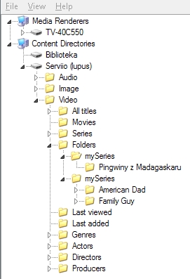

For testing purposes I created two folders today:
c:\downloads\mySeries (containing files that can't be processed via online metadata tags)
e:\download\mySeries (containing searchable files via online metadatatags)

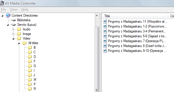

AV Media COntroller sees them correctly but TV doesn't:
files from c:\downloads\mySeries are ONLY visible in /Video/All titles "P" virtual folder (should be also visible in /Video/Folders/mySeries)
files from e:\download\mySeries are visible correctly in /Video/Series etc..
In attached log i've put some comment lines: 1, 43, 143 all starting with "***********"
Additional thing: When I switched off "Keep library automatically updated" and saved, the serviio service deleted all content from DB and I had to force refresh.
I hope that this will help you a little.
test_serviio.zip
Log file with comments in it
(5.74 KiB) Downloaded 786 times
Files not visibile in /Video/Folder/mySeries
Correct folder tree structure in AV media controller that isnt visible on TV

In the log you can see the TV is sending Browse() requests for the same folder in both cases (objectID = V_F#FOL_R62), and AV Media Controller seeing it properly I think it's a problem with the TV (probably dealing with names rather than id's).
