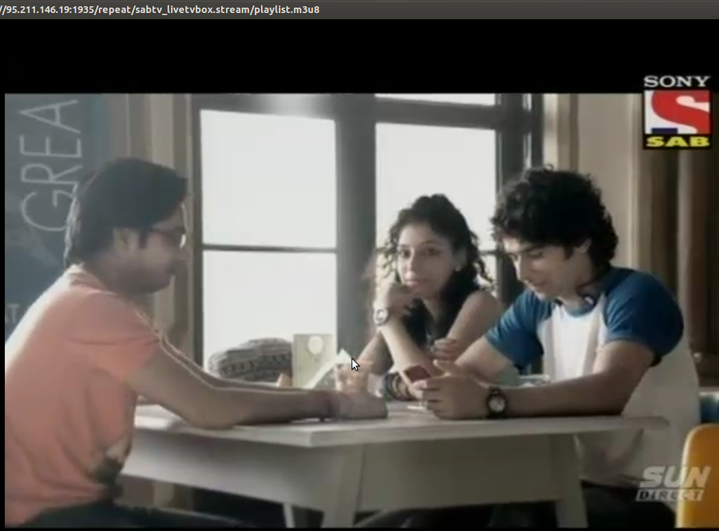

its Live Channel, its not video file. see the attachment (its screenshot)
Screenshot the channel
