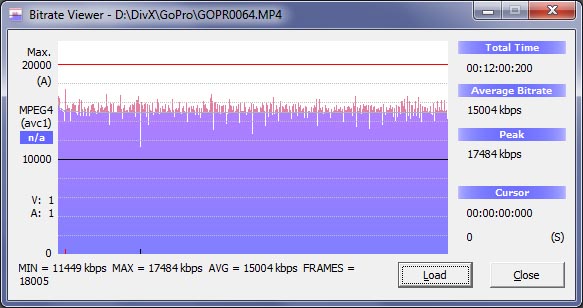

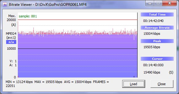

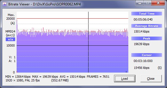

I made some captures with bitrate viewer on 3 different videos from the GoPro (all videos have same playing issues) :
GoPro Video 1
GoPro Video 2
GoPro Video 3

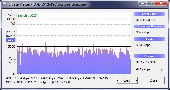

And the working video, with a much lower bitrate...
The downloaded working video : much lower bitrate...
