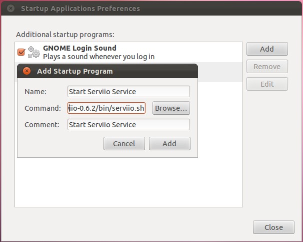

Provided you can are running Ubuntu 11.10 Desktop or Ubuntu 11.10 Server with Gnome GUI and Serviio starts/runs ok manually but won't start automatically upon boot, then here's an alternate method to make it work.
If you followed the Serviio Wiki Ubuntu 11.10 Installation Guide and Serviio Server starts manually, but won't automatically start, then go to the terminal command line (Ctrl-Alt-T) and remove the Serviio startup script you created by:
1. Type: cd /etc/init
2. Type: sudo rm serviio.conf
3. To confirm it's gone, type ls -l and make sure serviio.conf is not listed.
To use this alternate method to make Serviio Server automatically start when Ubuntu 11.10 boots, follow these instructions:
1. Click on power icon (top right) as shown below:
Capture_01 Mar. 20 13.51.jpg (4.2 KiB) Viewed 35453 times
2. Click on Startup Applications as shown below:
Capture_01 Mar. 20 13.58.jpg (16.97 KiB) Viewed 35453 times
3. Click "Add" and the following menu will appear:
Capture_01 Mar. 20 14.43.jpg (40.49 KiB) Viewed 35452 times
4. For Name, type "Start Serviio Service".
5. For Command, make sure you point to the path where serviio.sh is located. You can use the Browse button to find it too.
6. Click "Add", then click on "Close".
7. Choose "Shutdown - Restart" to reboot Ubuntu.
That's it. Serviio Server service should now start automatically upon booting Ubuntu 11.10.

That's right. This is the desktop version. But no one has announced proposals for the startup script located in /etc/rc.local. Maybe my suggestion would be helpful?
serviio-buddy
Posts: 132
Joined: Fri Jan 20, 2012 5:24 pm
Location: United States
Post Fri Mar 23, 2012 4:37 pm
Re: Unable to get serviio to run on boot Ubuntu server 11.10
I may try your suggestion as I've just installed the 12.04 Desktop Precise Daily Build.
Please note that the problem these users reported in this thread was "Unable to get serviio to run on boot Ubuntu server 11.10".
They are using the headless Ubuntu Server 11.10 edition, not the desktop edition.
Previously, I posted that I used the wiki install guide for Ubuntu 11.10 Server and Serviio automatically loaded up boot using Ubuntu 11.10 Desktop and Ubuntu 11.10 Server with Gnome installed.
When I tried the wiki install guide again on the Ubuntu 11.10 Server (headless version), Serviio would not automatically start on reboot.
serviio-buddy
