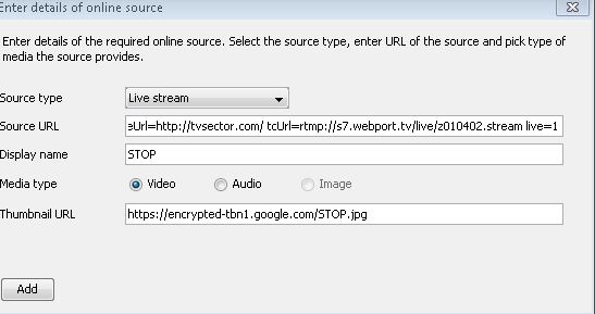

Workaround:
I am no serviio expert or ffmpeg or dlna expert but it appears, the serviio by design adds only valid media into its database by reading “ffmpeg –i” outputs. Meaning, the stream has to be valid when you add it the console for this workaround to actually work.
The method Cerberus mentioned above works but it kills all legit streams as well. Here is how you can kill or let is stop the stream right from the renderer you are currently using.
1.Create a folder called “STOP” then add a 20 seconds video file (eg: STOP.avi) and a thumbnail called Stop.jpg to the folder. Next add this folder to serviio console and marked as “Video”. If or when you want to stop the ffmpeg service for this renderer, you simply go click “STOP” -> STOP.avi. A new ffmpeg process will kick in killing previous process and also this new process with stop as soon as it’s done streaming stop.avi (20 sec).
OR
2. Find a short youtube video, add it to serviio console per youtube single video wiki instruction, and name it “STOP”. If or when you want to stop the stream to a renderer, simply go to that folder and click play “STOP”. The ffmpeg stop the current stream and spun a new stream for the renderer for the length of the youtube video and stop.
OR
3.Find a temporary valid stream (veetle stream), add it to the console, name it “STOP”, and finally add a thumbnail for it (eg: STOP.jpg). Once the veetle stream becomes invalid use it to stop the ffmpeg process by intentionally invoking stream to play that does not exist which causes ffmpeg process to crash. And again doing so, it will only effect current renderer all other active renderers and its corresponding ffmpeg process stays intact.
NPuser

Exactly the point. The short video suggestion above is to spun a new ffmpeg process killing previous ffmpeg stream. I am no way implying that the stream gets downloaded and stored somewhere in the file system.
Here is a scenario:
You are watching sky movie hd in a tv then you decided to take a break. You simply turn the tv off and walk away. Just because you turn tv off does not mean the ffmpeg is not streaming, the ffmpeg is still still streaming data to the tv's original ip address. It just happens at the moment the tv is off. The ffmpeg process will continue to stream until either stream fails, timeout occurs somewhere, or someone turns tv back on and starts whole new stream. If there is no timeout or error with sky hd stream, and the serviio pc is continue to be up, the sky hd stream could go on forever. Now, nothing about the stream other than log is stored in server so running out of the space is not an issue but people with limited bandwidth or capped bw its whole new headach.
So people with limited bw or capped bw, they can try what I suggested above. Like i said it is the way ffmpeg works and has nothing to do with serviio. It may not work but it just a suggestion.
