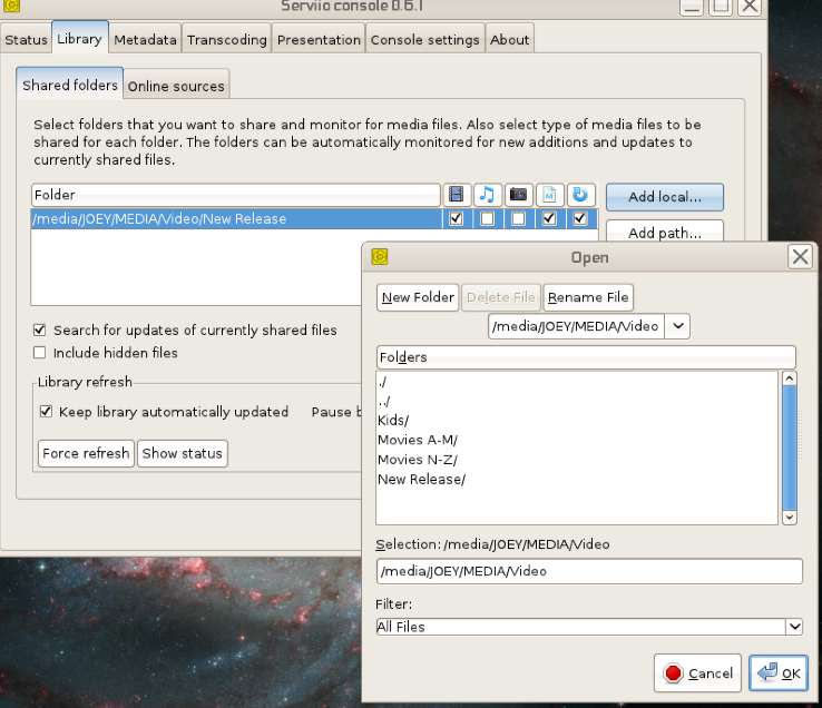

I'm a new user to Serviio. I currently run Suse Linux 11.4 and have tried other uPNP server programs and never had one that worked that well. Today on my Windows PC, i installed Serviio to try it out and it worked great, it streamed to my xbox & samsung blu ray player. I found a linux version of Serviio, so i downloaded and tried it. I started the service, ./serviio.sh&, and ran the serviio-console.sh in the GUI. The console window popped up and i clicked on the folder i wanted to share. I then went to both uPNP devices, and they discover the Serviio server and the folder, but the contents of the folders are empty.
The log file showed this:
2012-01-28 19:33:46,099 INFO [LibraryUpdatesCheckerThread] Started looking for updates to currently shared files
2012-01-28 19:36:54,861 INFO [LibraryAdditionsCheckerThread] Finished looking for newly added files
So it looks like it works, but the files never show. I read somewhere about UTF-8 has to be enabled somewhere, but the docs on it was vague to me. I also read in this forum that somebody used 2 "//" on the beginning of the path, but that didnt work either.
What do i need to do so i can get my files to be read? I really like this server as compared to Twonky (randomly disconnects my Blu-Ray connection), and i want to run this on my Linux box since i use it as my file server also.
Attached is how i have it loaded on the config screen.
2nd question, hopefully quicker, is there a web interface to config the server? I went to http://localhost:8895, and nothing displays or no error messages. Right now i have to connect to my server via VNC to configure it from my Mac Book. Is there another port to use? I ran netstat and grep'ed for that port or different ports, but didnt see anything, and i also added the rule to the firewall for TCP port 8895/ UDP 1900. Once i get this resolved, i would like to get it where the Serviio server starts on bootup.
Thanks for your help,
Screen shot 2012-01-28 at 7.43.40 PM.png (217.93 KiB) Viewed 26544 times

check the serviio user has permission to access the folder were the files are stored.

Thats what i was thinking after i had sent it. But now here is my question to that. The movies i am trying to share are stored on a External USB Drive mounted on /media/BACKUP (and its formatted NTFS). I installed the serviio files in the /root folder, and checked the file permissions on folder that i am trying out. Below are the permissions:
linux-MERCURY:/media/BACKUP/TV/2.5 Men S1 # ls -l
total 4525696
-rwxrwxrwx 1 root root 5148 Jan 28 21:25 ._2.5 Men S1E01.avi
-rwxrwxrwx 2 root root 183734272 Aug 18 02:08 2.5 Men S1E01.avi
-rwxrwxrwx 2 root root 183891968 Aug 18 02:11 2.5 Men S1E02.avi
-rwxrwxrwx 2 root root 183465984 Aug 18 03:08 2.5 Men S1E03.avi
-rwxrwxrwx 2 root root 183474176 Aug 18 03:15 2.5 Men S1E04.avi
The owner is root and they have RWX on all 3 groups. Is there anything i am missing, or something i have to change?

serviio cannot be run as root, it has to have its own user account and as a side note i didnt know linux could access NTFS partitions i though they had to be fat32?
