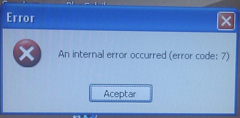

When a boot the computer I get a pop-up where I can read: "An internal error ocurred (error code: 7)" .
I try to start the Serviio service, because is stopped, then it starts, then stops 2 seconds after.
I uninstall serviio, I reboot, then I reinstall, (of course with the last version even) and I get the same error, after a reboot
I stop the firewall, and nothing positive.
I reinstall Java also and the problem is not solved
Can you help me with the problem??-
And is possible to get a table, with the errors, or explain me the error 7
Many thanks in advance

that is a window error code nothing to do with serviio so we wont have the information on what that error means.

Thank you very very much
It's working fine.
This weekend I click in right button in MI PC icon > Properties > Advanced > Environment Variables > then I changed "%USERPROFILE%\Local Settings\Temp" for c:\temp (for TEMP variable), and c:\tmp (for TMP variable) .
Then i uninstall serviio 0.6.0.1 and I re-install 0.6.0.1, and WORKS FINE

can you get into the serviio console?
if yes
1. go to transcoding tab
2. change the temp location to C:\serviiotemp\ ( you may have to create this directory\location on your pc )
3. save setting ( press save button )
4. restart pc
5. do you still get error message ?

Hi Cerberus, I just made the changes you tell me and everything came fine, no more errors message.
Thanks for your help, much appreciated.
Regards.
Post Mon Jan 23, 2012 7:51 am
Re: Salutations and Error code: 7
Welcomes :)
ok now a little background on why we now get this error.
This is cause by serviio trying to add its tempory directory into the \program files\ and under the UAC functions of windows 7 this is not allowed, so we have to create a new location for it to put its tempory files.
ZIP - to fix this completely we need to change the temp path to C:\USERNAME\application data\serviio\temp\ or as i did for the fix uses c:\serviiotemp\

Post Tue Aug 07, 2012 5:06 am
Petr,
I'm inclined to disagree with the following comment:
zip wrote: It only seems to be a problem for users with space in the user name, as described in the above ticket.
There is no space in my user name (which is "root") and I started to experience this problem.
It is my belief that somehow a function within Serviio creates temporary files and directories which in my case appear in the "C:\WINDOWS\Temp" and the "C:\Documents and Settings\root\Local Settings\Temp" folders. Many of the files and directories created have names similar to "e4j3.tmp_dir" (a folder) and "e4j3.tmp" (a zero byte file). The directories created in the temp folders referenced above contain files with names similar to "exe4jlib.jar" and "i4jdel.exe".
These files and directories are not ever being purged from the temp directories referenced above (unless the user invokes "Disk Cleanup"), thus creating a very large number of files and directories with names which seem to increment. I suspect that whatever algorithm is used to create names for these files circles back around and eventually tries to use a duplicate name or some such similar problem.
Whether my logic is correct or not, I resolved the problem on my PC by manually purging the temp directories of files and folders which I believed to have been created by Serviio.
The earlier suggestion which changed the environment variables referencing the "temp" directory would have the same effect as manually purging the files and folders because it would then point to a new directory which is not yet full of similarly named files.
I hope that some of the information which I have supplied will allow you to pinpoint and resolve this problem.
