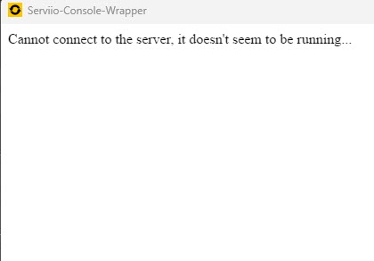

ServiioConsole.exe
Serviio Console Error
Serviio Console Error.jpg (8.74 KiB) Viewed 1359 times
Getting an error when opening the ServiioConsole.exe file. "Cannot connect to the server, it doesn't seem to be running". There is an "Open Serviio Console" Shortcut on the start menu which opens the application in a web browser. From here everything looks normal and I can see all of my mp4 files on the network drive, but none of them will open on the Television that uses the DLNA Server. I have checked the service in Windows Task Manager, and it is running, plus it shows as running in the browser. I have the PRO Version of Serviio and have never encountered this problem. I have uninstalled and reinstalled Serviio, uploaded my license file, but the behavior persists. I am running the latest version for Windows from the Serviio site. My OS Is Windows 11 Pro. I have not had any changes to my Operating System or Computer hardware. If anyone has any info that could help me, it would be sincerely appreciated. Thank you all. I have uploaded an attachment that shows the error when attempting to open serviio from the Console shortcut on the start menu. It is named "Serviio Console Error.

Post Wed Nov 12, 2025 7:01 pm
Re: ServiioConsole.exe
Have you tried using the web interface? If that works, I'd just use that and forget about the app itself. If the web interface works, then Serviio is running fine. There's no functionality in the app that isn't in the browser version. On the computer running Serviio just enter http://localhost:23423/console. On any other computer on your home network change localhost to the IP address of the Serviio computer.
