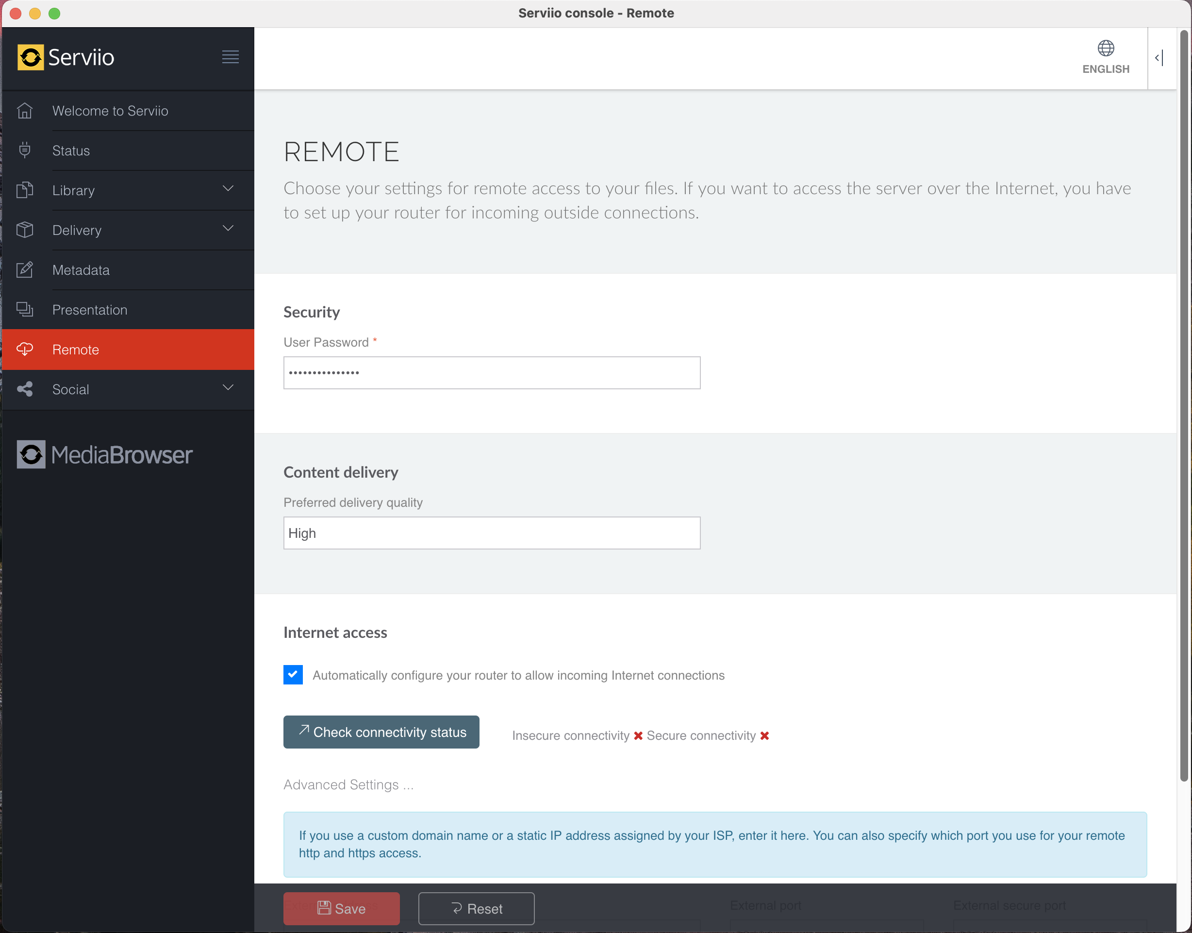

Can't access my remote server from outside the home wifi network.
Serviio is showing no connectivity.
Screenshot 2025-06-04 at 12.53.16.png (399.46 KiB) Viewed 21856 times

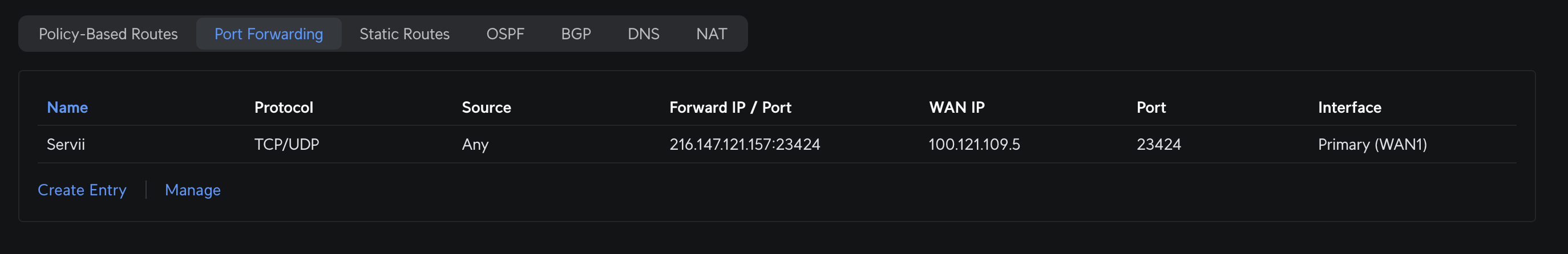

I've forwarded the port in my router settings. but still can't get connectivity via Serviio.

Are you trying to forward the port to an outside IP address?
None of the addresses in the listing are in a private IP block...

Good catch, I didn't notice that internal IP address. Your 216.147.121.x is in the public section of the approved IP addressing range. Home networks must use private IP address ranges. There are three groups of addresses that should be used in home networks. Using something in the public IP address range could cause routing issues.

While using an internal IP Address range with addresses not in the "private" address space is unusual, it will most likely not yield to problems (obviously you will not be able to reach a web-server using these addresses), the issue you experience ist most likley CGNAT.
Starlink ist not a real internet access. You are located behind a large NAT network shared with many others. Incoming connections are not possible or very limited (read about NAT hole punching, or setup a small virtual Server with a real IPv4 Address, connect with VPN to this, then forward everything to your home from t here, or buy a service which gives you similar).
Or maybe there is an option that you can buy an IPv6 address space from starlink, then, use IPv6.

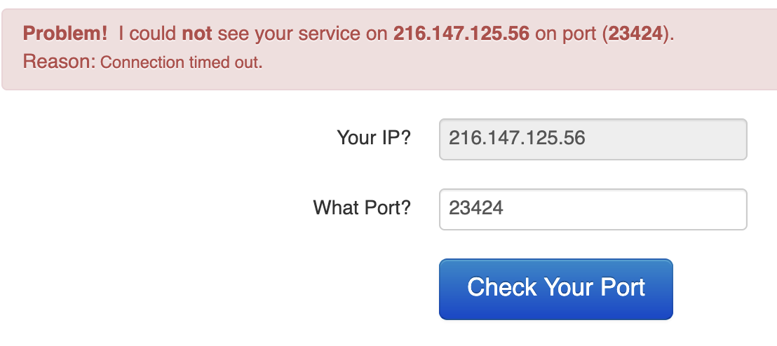

The port is forwarded in my Ubiquiti router but when I check it via portchecktool.com it says it can't find it.

All I can guess is Starlink is doing something different in their modems, although I don't know what that might be. Assuming your Starlink modem/router is not in bridge mode, the port has to be forwarded in it as well as your internal router. If it is in bridge mode, then in theory it should be invisible to the Internet stream. Just a guess on my part, but I think the port isn't being forwarded in the Starlink equipment.
