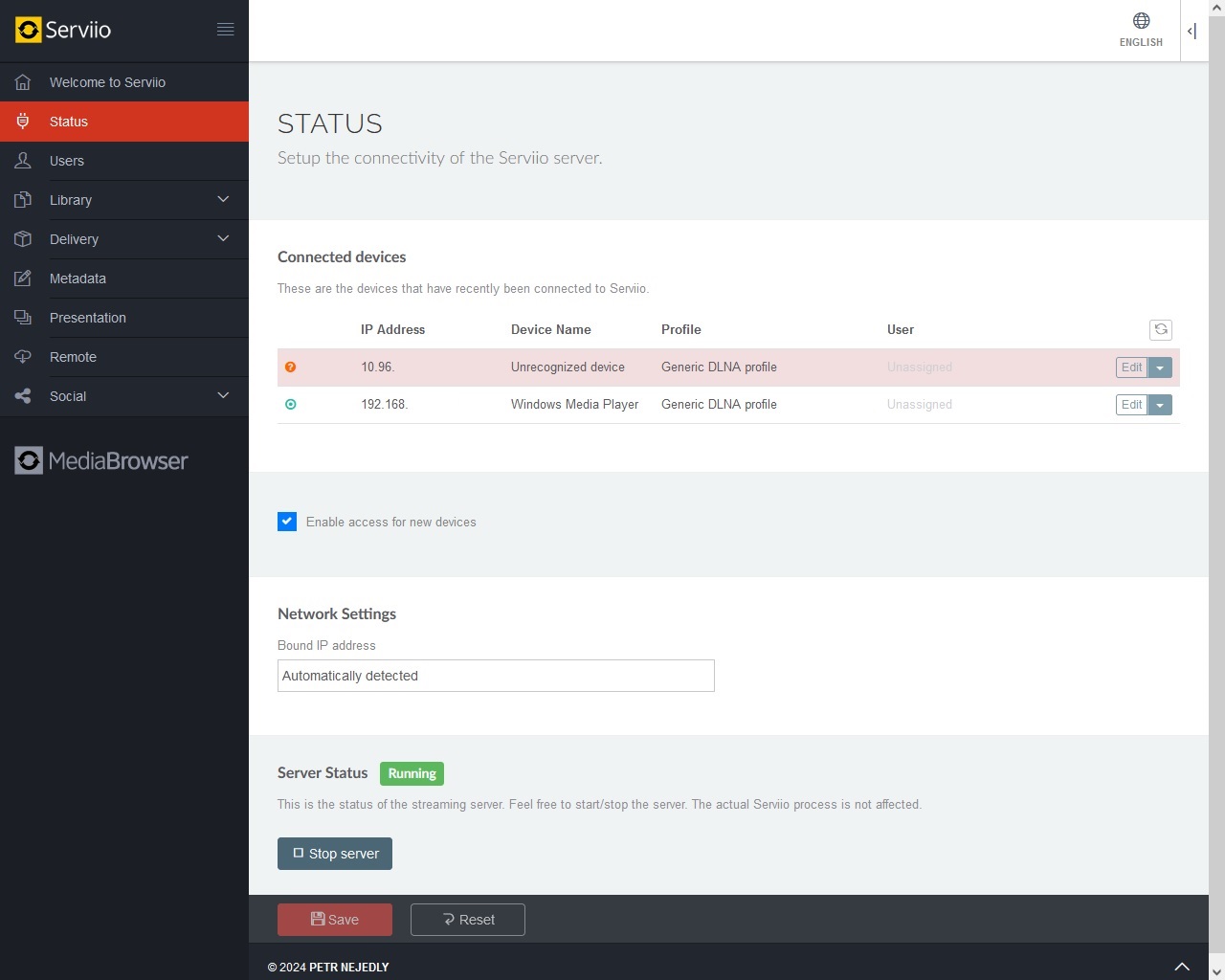

Hi all,
I am a bit concerned because the Connected devices Status is not updated with known WAN or LAN clients (ServiiGo- and web browser users).
The only DLNA device that has been discovered correctly is my Windows Media Player from my workstation when I double click on Serviio in my Network.
And now suddenly a strange ip not in the network range that I use is listed "10.96.#.#".
I saw other posts relating to this issue, but they didn't make me worry less and I disallowed the strange IP, but I wonder if that is enough.
This is a new Serviio install that I recently started using, so it could not be related to something lingering from an old network setup.
Because it does discover my WMP I assume that my setup is correct, but I can not confirm or deny that.
The only way to connect to Serviio is with the SSL/HTTPS protocol with strong passwords and I use Fail2ban on Serviio and my OPNsense box to ban bots and hackers after 1 failed login attempt, but obviously that is still not enough.
Please tell me what you need to investigate- and most of all to prevent this from happening and to discover the legit clients that connect, so I can start adding the required profiles.
I use a reverse proxy because Serviio doesn't support the SSL/HTTPS protocol with a Let's Encrypt certificate.
My setup is like this:
Proxmox container with Serviio - switch - OPNsense box - bridged router - Internet
Please advice

Post Mon Nov 25, 2024 5:56 pm
Re: Unknown ip address in Status connected devices
Most likely you connected something to your network (such as a laptop) that had previously been connected to a network that uses 10.96.x.x address, and when it connected to your network it tried to refresh that same IP address, which of course failed. But in that short time Serviio might have detected it and that's why it appears in the list. Serviio does not purge the list once the address is no longer visible, so you can manually delete it just to clean it up. The 10.x.x.x address range is still a private IP address, but because it can support so many IP addresses it's most likely used in a business network.
The lack of discovery of your other network items is likely due to your network configuration. As long as Serviio works as expected, I wouldn't worry about other devices not being detected. Serviio never sees any of my Roku players until I actually attempt to use Serviio to play media on one, then it shows up in the list and I can assign the correct profile to it.

Post Sun Dec 01, 2024 1:57 am
Thanks for responding.
I discovered that it was my phone that uses VPN with that IP address.
But it still does not explain why this didn't happen before because I use it on a daily bases and why my other devices (with and without VPN) are not recognized at all from the LAN and WAN.
Disallowing the phone on the Status page of the console didn't make any difference, because I was/am still able to logon with ServiiGo, so I didn't suspect that this was the device.
Also even when I play media with my devices (ServiiGo and web browser) they are still not recognized.
I could simply follow your advice and not worry about it, but it would mean that Serviio 2.4 doesn't work like it is supposed to and that makes me worry still.

Post Sun Dec 15, 2024 9:57 pm
I might be able to help you, however I do not really understand what your question is?
Is it regarding your phone beeing visible in the console as potential candiate for DLNA playback? If the phone has DLNA discovery enabled it will find Serviio and (this is now a guess) it will submit its default IP Adresse to serviio which might be the address it uses to connect to the VPN.
Other phones are not visible, maybe because DLNA discovery is not turned on?
DLNA discovery and serviigo or mediaplayer/Bowser playback are two different things, AFAIK in the Serviio console you will never see a client using serviigo or the Browser bases player - at least it behaves this way on my Serviio Server - I even have DLNA playback disabled for any devices, I only use the Web-Player or Serviigo. Authentication is handled by Serviio based on the username+password. DLNA authentication is done by the IP of the client.
If you ask why you cannot add a profile for a client with serviigo: You dont need to add a profile. If you would like to add one, you dont need to use serviigo on this client you need a DLNA player (VLC will do for a test). However, DLNA discovery will only work in the same subnet, If you want to use DLNA playback (in addition to running DLNA discovery on the phone) with your phone you have either to put it in the same network where the server is running or use a VPN which uses a TAP device or ARP proxy to make discovery possible.
If you want to use Serviigo, you need only a network connection Layer3, no need to be locatedin the same network. only the port of the server has to be reachable. Open serviigo, type in the IP Adress of the server, authenticate. Done.
