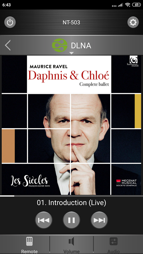

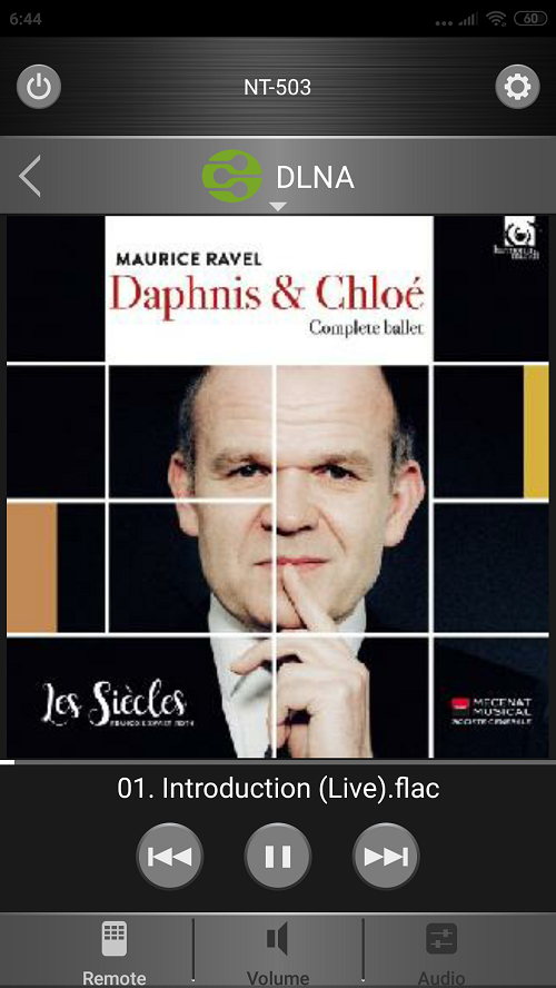

After making changes to the configuration files, the quality of most thumbnails has improved, but it still remains not perfect.
Look at the difference in image quality when listening to music with QNAP and Serviio. In the Serviio variant, small letters are
not readable and the picture is blurred. It seems that when setting the quality value above 1000-1500, it does not change in any way.
Are there any other parameters that can be changed to make the image quality perfect? Is it possible to make a selection
of the quality of thumbnails in the standard interface of the program? This is possible on the QNAP DLNA server.
atc98092 wrote:If you're using local files, and not online resources, I can only find this guidance:
Local poster
If there is a local image file representing a music album or a video it can be used... .
QNAP DLNA Server
QNAP DLNA.png (472 KiB) Viewed 90408 times
Serviio DLNA server
Serviio DLNA.png (317.84 KiB) Viewed 90408 times
