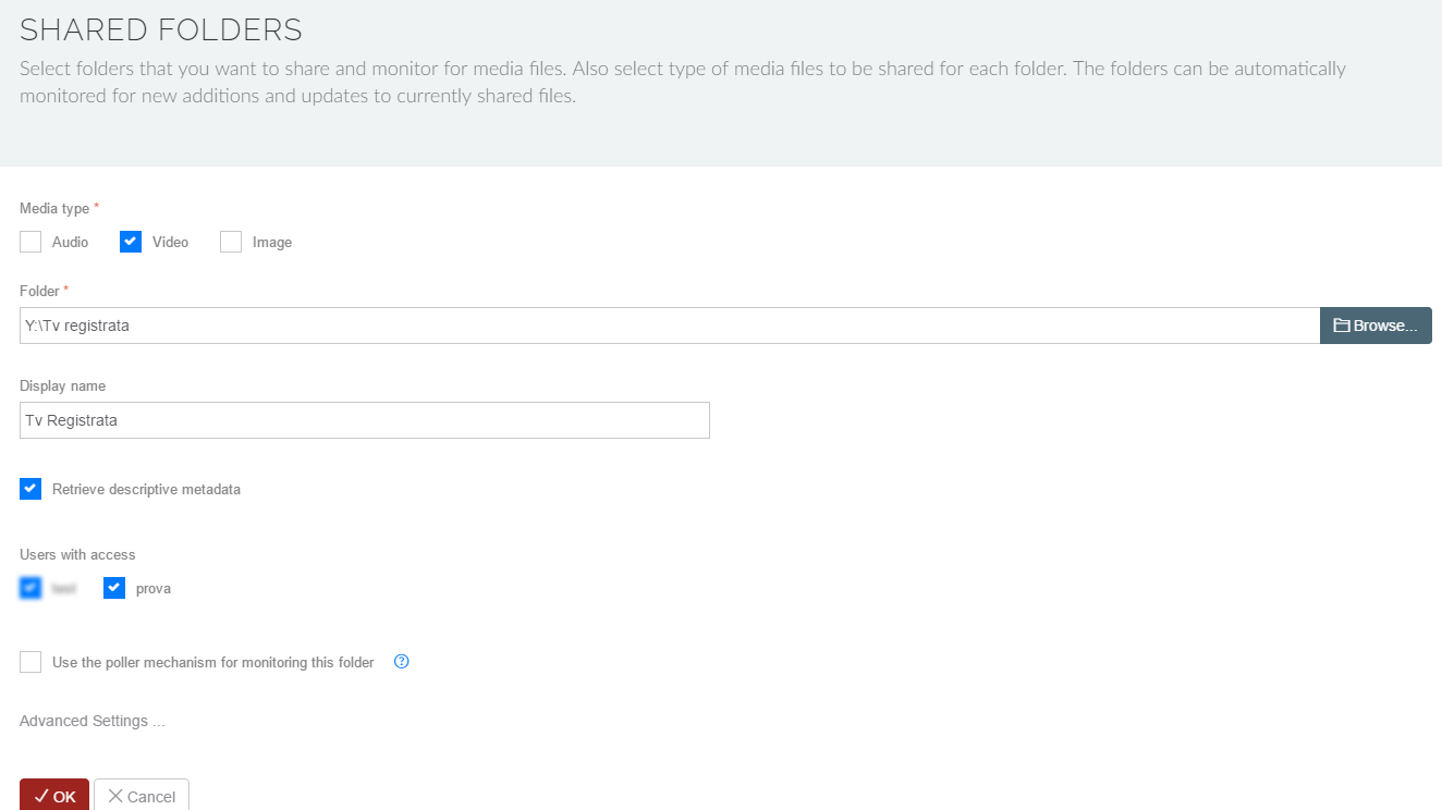

zanflix wrote:- created a test user and assigned access to a test folder (planning to set up more in the future)
"prova" user has access to the "TV REGISTRATA" folder, box ticked.
App works..browser doesn't.
Serviio Console
Post Wed Feb 24, 2021 3:15 pm
Re: MediaBrowser logs on from browser but shows no content
OK, thanks for checking that. It is where most users have made that error. I can't say why it's doing that now.
