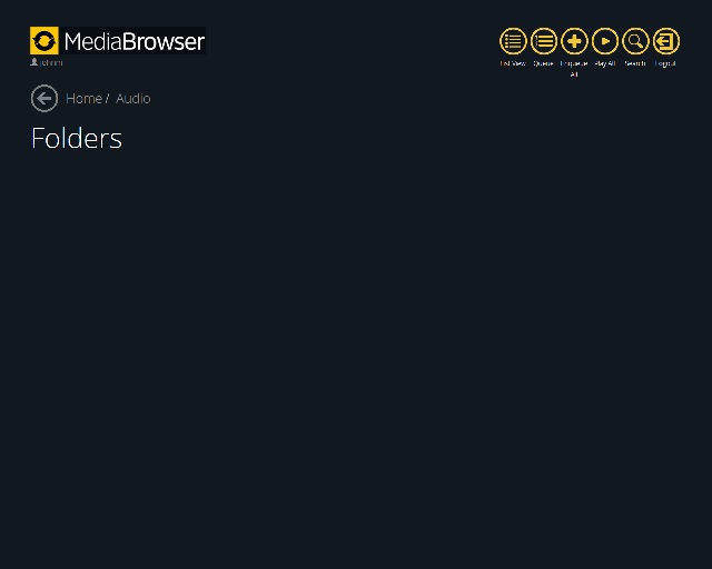

I just re-added all the audio (MP3) & video files to the same location as before, but only the audio files are shown in the media browser.
No videos are shown at all (series and movies).
audio folders.jpg (18.94 KiB) Viewed 6413 times
I attempted to reboot and to "Re-scan Video Metadata", but no video files are listed in the media browser.
I have the same problem with "Folders" (audio & video). No path is shown to browse to.

From that image, you're in the Audio portion of the MediaBrowser, so only audio files will be shown. You have to be in the Video section to see the videos. Check your Presentation settings in the console and ensure the Video section is enabled.

Thanks for your quick response atc98092,
I forgot to do the following:
Enable for the users "Users with Access" under "Shared Folders".
Now it works again.

Ah yes. I forget that myself sometimes. With the updates that came with Serviio 2.0, MediaBrowser requires users to be granted access to each shared media folder. It's a good setup, but that one little detail has to be done. :)
