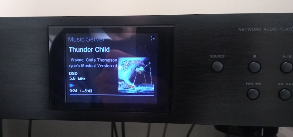

I have no problem with DSD128 5.64MHz streaming from Serviio to my Pioneer N50A.

Acetone
Posts: 29
Joined: Tue May 15, 2018 8:03 am
Post Sun Jul 05, 2020 12:38 pm
Re: Does Serviio downgrade DSD (DSF) playback of audio?
Vbaldacc wrote:
Acetone wrote:I have no problem with DSD128 5.64MHz streaming from Serviio to my Pioneer N50A.
And its definitely showing as DSD 128 5.64MHz on your player correct?
Cheers,
Vin.
Yes is displays as DSD 5.6Mhz
I have Serviio 2 installed on a Synology DS718+ NAS

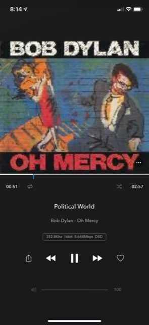

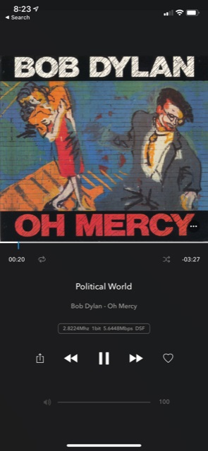

Post Thu Jul 09, 2020 4:15 pm
Just to provide some visuals to my problem. You will notice using the same app to my Auralic streamer, I am seeing a lower sample rate representation streaming via Serviio versus MinimServer. The other thing I am noticing, is that the album artwork is of a lower quality via Serviio compared with other UPnP/DLNA streaming tools.
I am not sure whether these issues can be resolved but if so, I would love to know where I can make any adjustments/changes to remediate.
Thanks in advance for any help/guidance, as this is not obvious to me within the console. Thanks!
