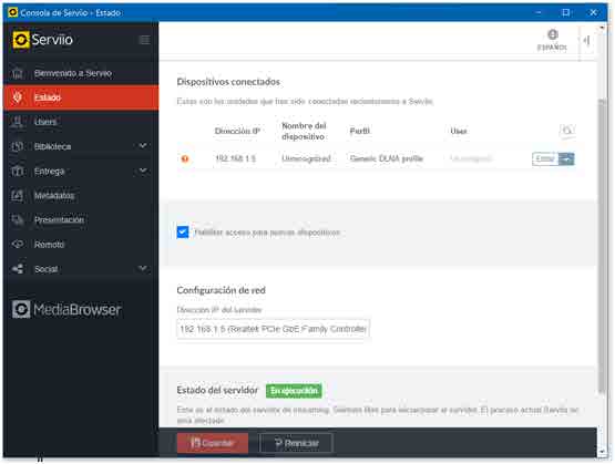

I have a Windows 10 Home operative System. The IP of my PC is assigned to 192.168.1.5 and it runs Serviio as service.
The Internet adapter is Realtek PCIe GbE Family Controller, and it is selected as that in the Serviio Console.  
I also have the Serviio running as service in my Windows 10 Home.
Everything seems as before it stops working except for the Serviio Console.
The only connected device is my own PC running the Serviio service.

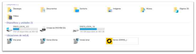

This is actually the Serviio running as service in my PC
This is the Serviio Console
