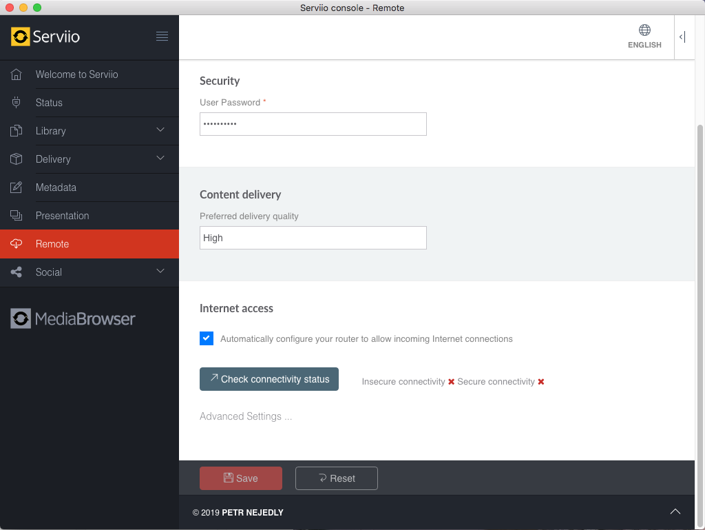

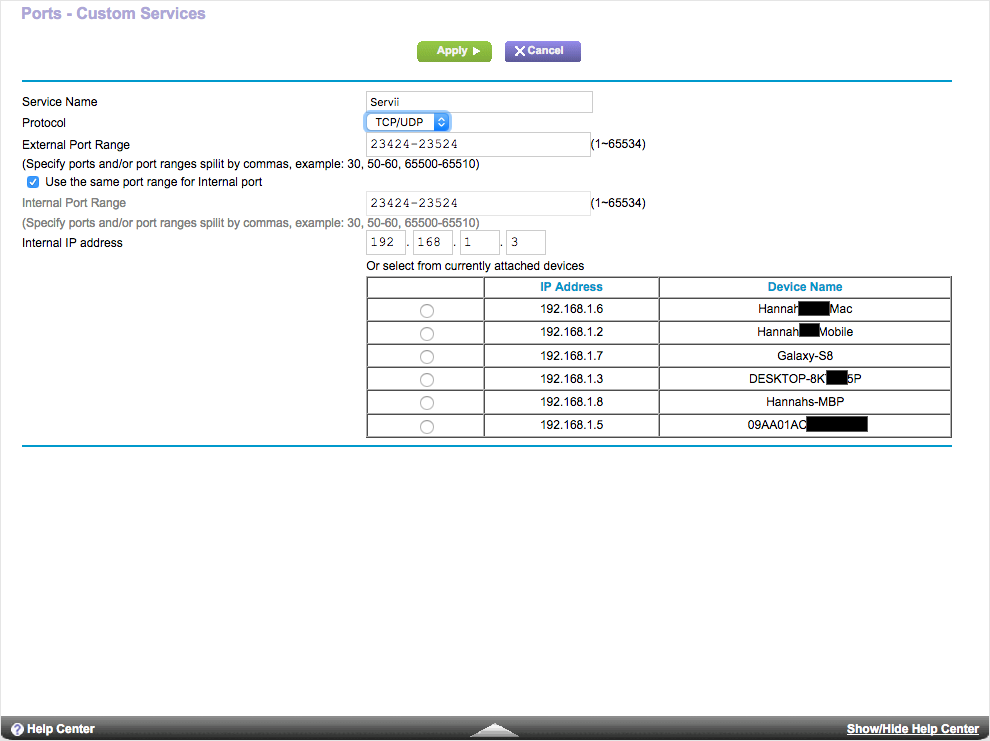

This was working just fine the other day, and then all of a sudden, it just quit working. I haven't made any router changes, serviio changes, or network changes lately.
I can stream from the host computer and access serviio using the http://localhost:23424/mediabrowser/#/b ... id=0&bid=V in my browser on the host machine and I can stream directly to the PS3 without issue.
My phone's browser will not connect using the ip address and my laptop will not connect nor will my roommate's desktop connect. All devices except the phones are hardwired to the router.
Double checked all router settings, checked all wired connections and ethernet ports, rebooted host computer and router, uninstalled and reinstalled serviio and still no connectivity. I ran a router firmware update and no change.
All wired devices can connect to the internet and browse just fine. Just not to the serviio server (w/ exception to the host computer and the PS3).

Well I figured it out on my own. Somehow, my allocated internal ip address for the media server got changed from 192.68.1.4 to 192.68.1.3
Not sure if somehow hacked the network or the settings somehow changed, but I've changed it back and changed all the passwords. Now everything works again.
