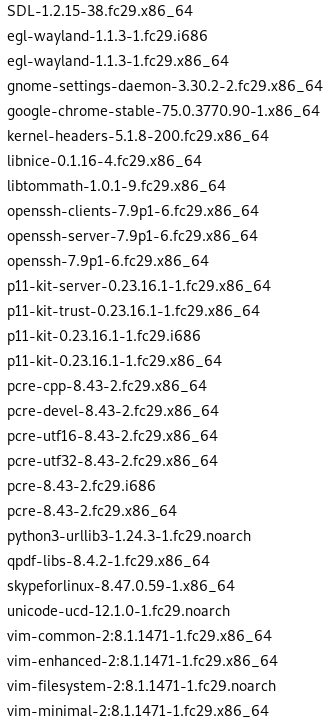

Some days suck. Using Fedora 29 on dual Cpu Asus motherboard. Fedora pushed an update set including a kernel update.
So after rebooting , serviio refuses to start as a service -; Note I add some debug code to print the main Env Vars

We at least get a launch
Suggestions//???///???///???///??///???//???///???///???
the update that broke startup
Screenshot from 2019-06-14 21-01-00.png (77.27 KiB) Viewed 5032 times
