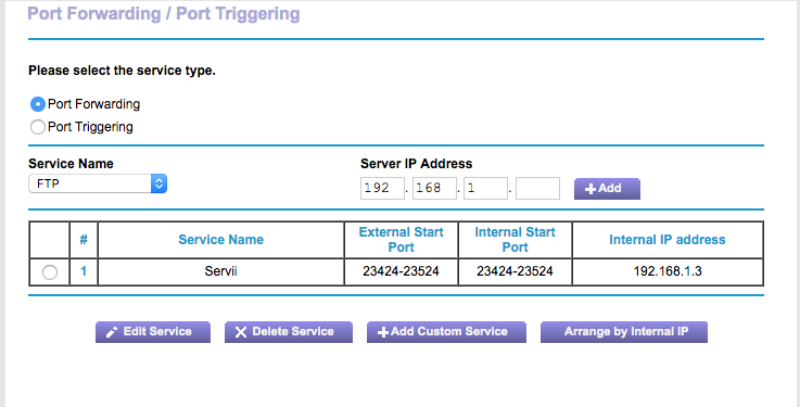

Screen Shot 2019-04-28 at 16.26.43.png (50.99 KiB) Viewed 22384 times
The port appears to be opened in the router configuration.

You've opened every port between 23424 and 23524. I suggest changing it back to a single port and add a second forwarding rule. You're really opened your router up this way. If I recognize it correctly, that's a Netgear router. It's possible that entering a port range doesn't work on them, so even with both numbers it might still only be forwarding the first port.
Also, when you are attempting to use the secure port, remember the URL has to start with HTTPS, not HTTP.

atc98092 wrote:You've opened every port between 23424 and 23524. I suggest changing it back to a single port and add a second forwarding rule. You're really opened your router up this way. If I recognize it correctly, that's a Netgear router. It's possible that entering a port range doesn't work on them, so even with both numbers it might still only be forwarding the first port.
Alright, I will try that. Thank you.

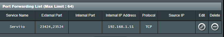

Yes...I have forwarded both ports as TCP (I did try both) to my server;
Annotation 2019-05-13 071125.png (11.11 KiB) Viewed 22285 times

One more piece of info: if I try to connect locally (https://192.168.1.51:23524) I get a message in the browser that says "Not Found".
Is this expected behavior?
Post Mon May 13, 2019 3:36 pm
Re: Can't Access Serviio Remotely
MarcB wrote:One more piece of info: if I try to connect locally (https://192.168.1.51:23524) I get a message in the browser that says "Not Found".
You have to include /mediabrowser after the port (https://192.168.1.51:23524/mediabrowser). I tried it on mine and it worked after I added that. I've never attempted external secure access, so can't say if mine would work that way as well.

Including "mediabrowser" did work! Ok...so how come when I click "Check connectivity status" on the remote page the secure check always fails?

I tested the port forwarding with "https://www.yougetsignal.com/tools/open-ports/" and it reports 23424 as valid and 23524 as invalid!
Any ideas why this port is invalid? Also, I created a 2nd entry in the port forwarding table for 23524 so the two ports each have their own entry...and no difference...it's still invalid.
I have to believe its a setting in serviio or the OS but have no idea where to look.

MarcB wrote:I tested the port forwarding with "https://www.yougetsignal.com/tools/open-ports/" and it reports 23424 as valid and 23524 as invalid!
Disable your firewall and antivirus and see what happent's then.
No setting in Serviio. Those ports are hard baked into its configuration. They can be changed, but not easily. But it does sound like something in the OS or security software is blocking it.
