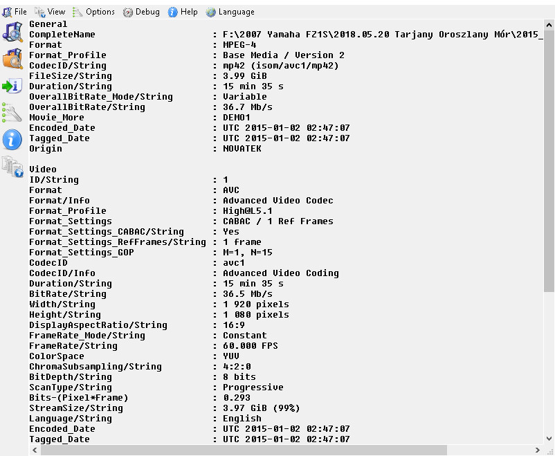

Im getting "Video codec not supported" Error , transcoding is enabled, but still can not play
Windows 10
Serviio 1.9.2
Samsung UE40D6100
video is made with Git2 GitUp action camera , 1080p 60fps
i try'd Media Browser: it plays the videos on the PC, but on the TV i get only error. :(
Details attached!
Media info
mediainfo git2 gitup 1080p 60fps .jpg (134.64 KiB) Viewed 8802 times

What profile is assigned to your TV? My guess is the profile isn't calling for transcoding, but your video has H.264 L5.1 video, and I think your TV only supports L4.1 or lower. Can't say for certain, but my guess. You could try a different profile, such as the DirecTV profile, which transcodes everything.

I dont know much about L5.1 or L4.1 wich one is supported by the TV or not (if no transoding is starting at all...)
atc98092 wrote:What profile is assigned to your TV? My guess is the profile isn't calling for transcoding, but your video has H.264 L5.1 video, and I think your TV only supports L4.1 or lower. Can't say for certain, but my guess. You could try a different profile, such as the DirecTV profile, which transcodes everything.

The file is not being transcoded (from the log) and it probably needs to be for your TV.
Try this:
  • Edit the file \config\profile.xml
  • Find the sam_h profile - starts with <Profile id="sam_h" name="Samsung TV / player (H-series)" extendsProfileId="1">
  • Change the line in that profile
    <H264LevelCheck>FILE_ATTRIBUTES</H264LevelCheck>
    to
    <H264LevelCheck>ANY</H264LevelCheck>
  • Save the file
  • If Serviio Version 1.9.2 then in Serviio Console, Status tab (toward the bottom) press Stop Server and then press Start Server - this forces Serviio to reload the new profiles (if an earlier version of Serviio then restart your PC to reload the profiles)
See how that goes.
For the techo's: Even though the file is being tagged as a High 5.1 Level in the metadata/header that is contrary to what the file attributes are telling us (if I do the maths on the file attributes the file is only a High 3.0 Level) - see http://wiki.serviio.org/doku.php?id=get_h264_level. As the file attributes are 3.0 the transcode statement <Matches container="*" vCodec="h264" profile="high" levelGreaterThan="4.2" /> is not being triggered when it probably needs to be. Setting the H264LevelCheck to ANY will use either the header info or the file attributes, whichever is higher --> the transcode statement should now get triggered.

i changed the "H264LevelCheck" to ANY under the "H-series" , i get the same error again :/

Surprising - did you check the file is still not being transcoded according to the log? Did you restart your PC just in case? You are still using the Samsung E/F profile?
Some things to perhaps try:
  • Try changing that line to <H264LevelCheck>HEADER</H264LevelCheck> and restart and test again
  • You could also add this line to the E/F profile (just before the <Transcoding> line) and see if that makes a difference but this is grasping at straws.
It should be getting transcoded by this line in the H profile (once it recognises this as a High 5.1 file)
