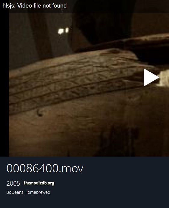

error in mediabrowser "hlsjs video file not found"
just bought the Pro license and having problems with the mediabrowser. audio und photos are working as expected, but when trying to play videos (in different formats) i get the error "hlsjs video file not found". I didn't found any helpful information on the internet.
Hope somebody can help me with this issue, because Serviio was the only longtime solution so far working without problems on my Synology 413j.
btw I activated debug mode for the logs but serviio.log is not giving me any logs when trying to play a video.

First try clearing your browser cache. Others have reported this worked for them.
Post Tue Aug 29, 2017 2:05 pm
Re: error in mediabrowser "hlsjs video file not found"
It's probably ffmpeg failing. Not sure it's because the way it's been compiled for Synology or something else.
You might ask Patters on the NAS sub-forum.

@atc98092: not working, tried different browsers with same outcome
@zip: ok will do. btw: serviigo android app works with vlc player and does play the videos

I'm having a similar problem getting "hlsjs video file not found". I'm doing an SSL redirect from external, but this worked fine until I upgraded to v1.9. I've already tried clearing my cache, so please don't suggest this. Also, when I review the serviio.log file, I see a lot of Java errors.

It could be several reasons. I'd need the complete detailed log of trying to play the file.

so, I would like to help. could somebody tell me where and which logs you need (because the serviio logs did'nt contain anything, or I have to tweak permissions...).
Post Thu Sep 07, 2017 10:19 am
you could turn on Dev tools in Chrome, go to the Network tab and try to open the video in MediaBrowser. then post the network call details here (there will be many, and some of them will include calls or the Manifest files etc).

this is what the dev tools are showing (get process is aborting after 10s, so @remlei thought on the timeout seems not bad):
http://x.x.x.x:23424/cds/resource/93231 ... diaBrowser
GET /cds/resource/93231/MANIFEST/HLS-0/MEDIUM.m3u8?profile=html5&authToken=&clientName=MediaBrowser HTTP/1.1

OK, after a lot of poking and some updates and reboots, it actually worked externally on the last attempt, so it may be a process load issue on my end. I've been meaning to do an upgrade on some of these systems, so I'll keep an eye on things, but the 1.9.1 beta patch did fix the actual connection issue.
I have NOT checked the logs to see if all the Java errors have resolved themselves or not. Just wanted to give you an update on my situation.

Post Tue Oct 24, 2017 5:42 pm
I have the same problem. Started occurring after upgrading to 1.9. From the thread, it's not clear to me what the solution is.
CPU on the server never dips below about 85% idle and the desktop machine I'm running the browser on is a fairly high end machine spec'd for music production.
serviio.log contains a Java stacktrace with the message "[ServiioStatusService] IOException occurred. Returning error code 500 to the REST layer. Message: Transcoded file '/tmp/Serviio/transcoding-temp-5d5543d4e440ac4d25f746261b6794b6.stf/playlist.m3u8' cannot be found, FFmpeg execution probably failed"
Post Wed Oct 25, 2017 12:46 pm
can you enable detailed log and try again, then post the log file?

Post Thu Oct 26, 2017 8:27 am
Are you using the bundled ffmpeg? Looks like our ffmpeg is either too old or too new ;-)

Post Thu Oct 26, 2017 8:37 am
Yes, I believe so. I don't recall installing it myself. That said, you never know. Does this help?
ffmpeg version git-2012-12-15-75b7e54 Copyright (c) 2000-2012 the FFmpeg developers
  built on Dec 15 2012 12:28:47 with gcc 4.4.3 (Ubuntu 4.4.3-4ubuntu5.1)
  configuration: --enable-gpl --enable-libfaac --enable-libmp3lame --enable-libopencore-amrnb --enable-libopencore-amrwb --enable-libtheora --enable-libvorbis --enable-libvpx --enable-libx264 --enable-nonfree --enable-version3 --enable-x11grab
  libavutil      52. 12.100 / 52. 12.100
  libavcodec     54. 80.100 / 54. 80.100
  libavformat    54. 49.102 / 54. 49.102
  libavdevice    54.  3.102 / 54.  3.102
  libavfilter     3. 27.101 /  3. 27.101
  libswscale      2.  1.103 /  2.  1.103
  libpostproc    52.  2.100 / 52.  2.100
Hyper fast Audio and Video encoder
Post Thu Oct 26, 2017 3:56 pm
it's from 2012. on linux you should either build one from sources (links to sources on serviio download page) or get the latest from some repo
