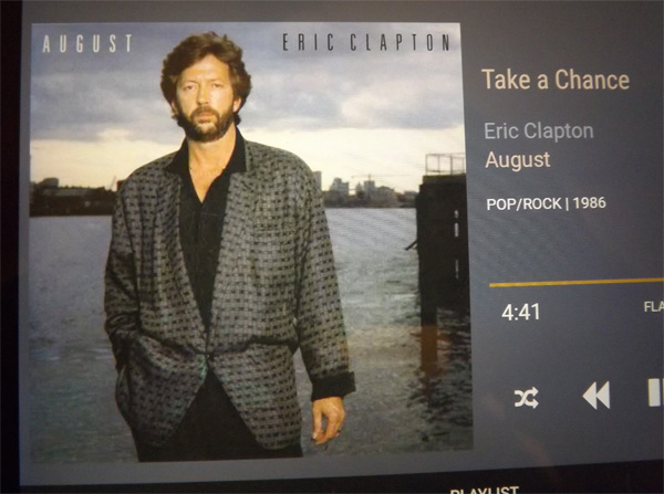

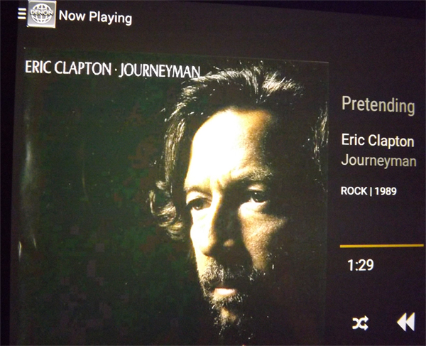

Post Sat Jan 20, 2018 12:35 pm
Re: Music Artwork issues and standards
Here are some examples of Audio HD artwork and pixels set to 600x600 (by adding -Dserviio.hdThumbnailResolution=600 see postings above).
It really is excellent.
(these are photographs of BubbleUPnP app and Serviio on my Kindle HDX 7).
Surely the Generic profile should be set to HD as the default (as I found HD and 600 pixels seems to work on all the devices and apps I tried including phones).
This would enable at least HD 320x320 which is a significant improvement on the basic DLNA size and "resolution".
There was a suggestion Serviio could not handle quality artwork - clearly it can - but the settings need to be activated.
