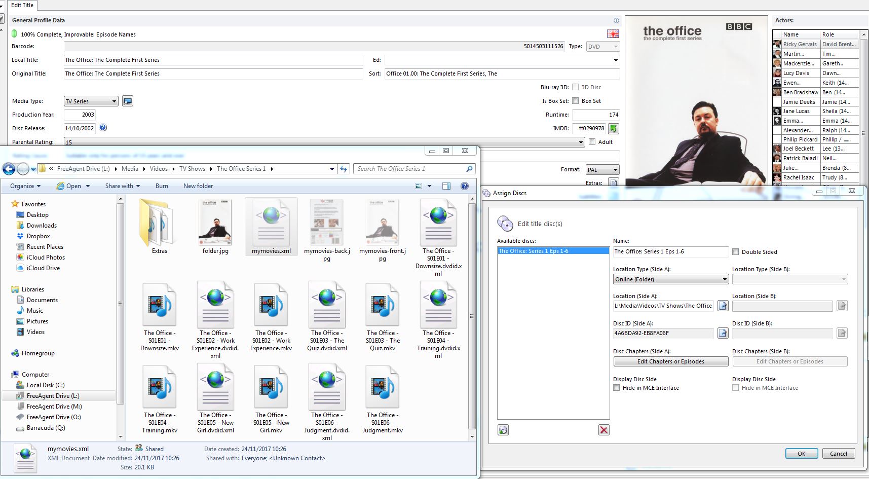

Post Fri Nov 24, 2017 11:18 am
Re: TV shows won't show in Series with My Movies metadat.
It's the UK version. I've changed all the names of the episodes in the series to the same format except the UK episode names eg. "The Office - S01E02 - Work Experience.mkv". Mine are mkv's as well. I've forced refreshed and left it a while but they're still showing in the Movies folder. I'm thinking the xml code might be different in My Movies 3 compared to My Movies 5. This is the xml:

I've attached a screenshot of the filen and My Movies settings.
My Movies The Office.JPG (253.87 KiB) Viewed 17713 times
Post Fri Nov 24, 2017 3:49 pm
I have to apologize. I completely overlooked you were using XML files for the metadata. I had no idea a program such as My Movies existed, so didn't catch your meaning earlier. Now that I've looked at it, I may give it a try.
I've never played with XML metadata files, so it's certainly possible there's something in the file that Serviio is recognizing inaccurately. For that, we'll need @Zip to take a look and see how his parser is reading the files.

No worries, thanks for trying to help. For now I can navigate to TV shows in the Folder section.
Post Mon Nov 27, 2017 10:39 am
so there is a single mymovies.xml file for the series / season and a separate xml file for each episode? If yes, could you attach both of these files?
Also, did you select MyMovies as your metadata source in Serviio console?
