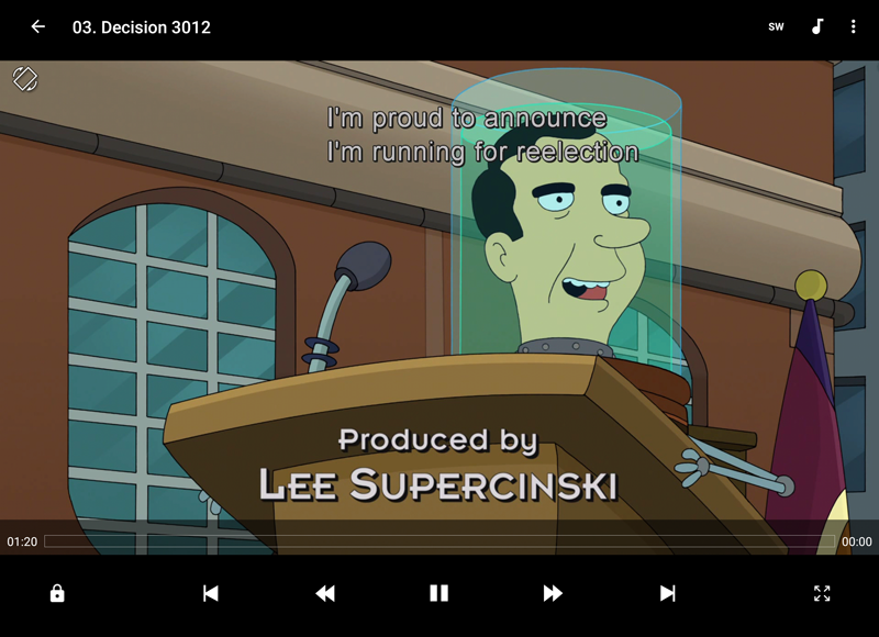

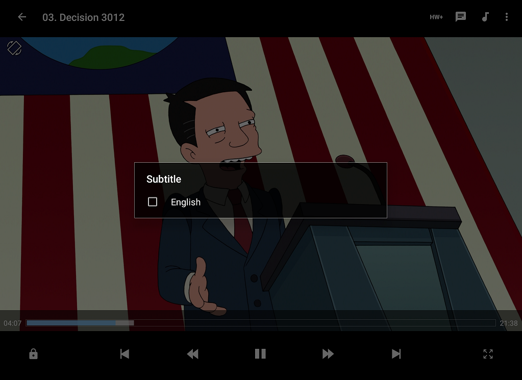

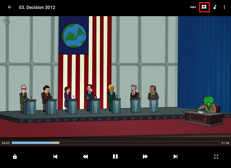

Attached is what it looks like in v1.4.
Video1.png shows the little bubble icon available. NO hard-coded subtitles, even though the console clearly shows them enabled.
(The TV acts the same way - as if the server's forced subtitles are actually optional and selectable. NOT SO in v1.8.)
Video2.png shows the popup box in Media Player after clicking on the subtitle bubble icon, allowing me to select subtitles.
Video3.png shows the video after selecting the subtitles.

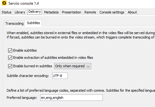

I'll post the console settings in a second, but subtitles are clearly selected.

Current console settings for subtitles:

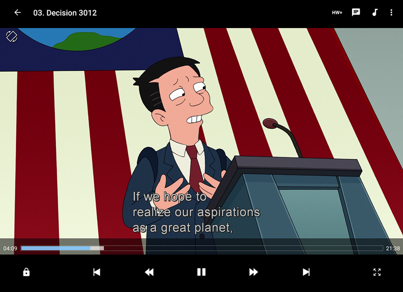

Here is the same video in v1.8 using the same Android app and MXPlayer. Also using the "Play Original" option.
Notice the missing subtitle bubble icon, and hard-coded, forced subtitles.

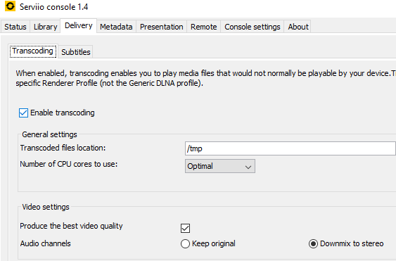

I did just realize that the trans-coding option is enabled, due to issues with surround sound on one of my devices. I'm forcing it to downmix to stereo.
1. Why can I seek in v1.4 but not v1.8, even though the settings appear to be the same?
2. What's up with the non-selectable subtitles when they used to be selectable, even though the server was set to forced?
3. Why is it no longer possible to install JUST the console in v1.8? Server is forced and you cannot deselect it.
(Serviio server runs on my Linux server, I don't want it on my Windows box. I only use the remote console app in Windows.)
Like I said, horribly broken.

That console is from 1.4, not 1.8. But if the file is being transcoded, seeking will never work. The file has to play without transcoding for FF/rewind to work. Like I said, 1.8 works fine. Any of my videos that play without transcoding I can ff or rewind with no problem.
