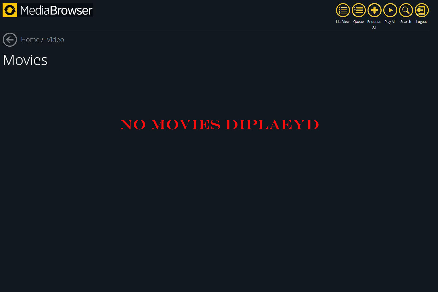

Hello everybody,
I have installed 1:52 Serviio Pro on my WHS2011 since today and need some help.
Everything works fine except for the field of instrumentation video in the Media Browser.
I get in the Media Browser in the Video / Movies -> No movies / files appears. Under Titles, Geners movies are displayed but unfortunately not movies.
Where can I adjust something that movies are displayed in the area Movies.
Please excuse my english, it's a long time ago when I learned it once.
Thank you for your support in advance.
Best regards
ServPet
MediaBrowser Movies without Movies.JPG (87.77 KiB) Viewed 4510 times

It is possible that your file name is not being recognized, so Serviio does not believe they are movies and does not display them. If you use the Folders view, and they appear there, that's likely the issue.
For the greatest odds of success, the best way to name a movie file is
movie name (release year).file extension
. So if you had the original movie "The Blob" (starring Steve McQueen), and it was in a MKV container, the file name should be "The Blob (1958).mkv".
