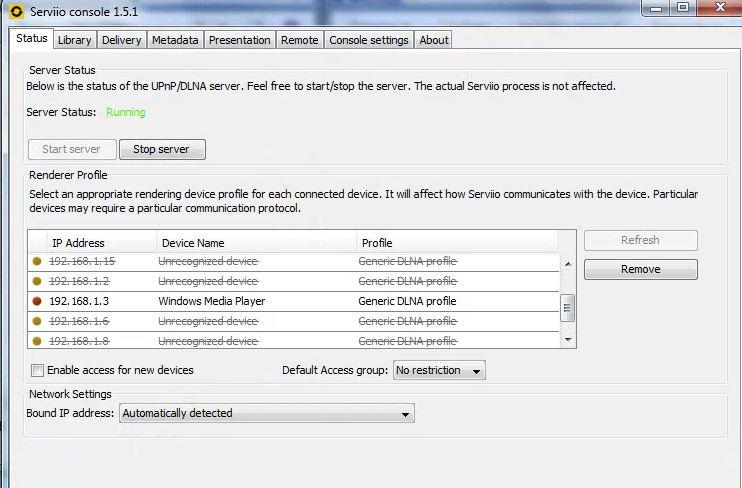

I have a server and a viewing computer on the same network; for a few months, no problems. A couple days ago, they stopped seeing each other, and I can't figure out why. I don't believe anything has changed.
1) Serviio server is windows 7, viewing computer is windows 8.
2) There are no firewall or virus protections on either computer.
3) Serviio status error: See screenshot below. The computer (192.168.1.3) is now seen as "Windows Media Player", and has a red dot next to it.
(It used to be "Unrecognized Device", which worked fine (with Generic DLNA profile))
4) I connected to Serviio with Kodi, which has dlna support, and has worked fine; with thumbnail support and everything.
5) The web server still works fine. I can watch via the :23424 port on any computer across the internet, not just at home.

the docs were outdated - you cannot manually add an IP anymore.
It looks like there is a Windows Media Player (or other Windows UPnP service) running on that machine, which might interfere with KODU.
You could try to disable it (found something here, the second paragraph: http://www.ehow.com/how_7209048_disable ... aring.html)

Oh my god you're right. I'm embarrassed I couldn't figure that out, even with it clearly saying "Windows Media Player" as a clue, which I ignored.
I had completely forgotten that I had accidentally started Windows Media Player - which had never been opened before - but closed it immediately, and that had immediately disabled all traffic from Serviio to XBMC/Kodi. Reminding me of why I never use WMP. Thank you so much for figuring this out.
