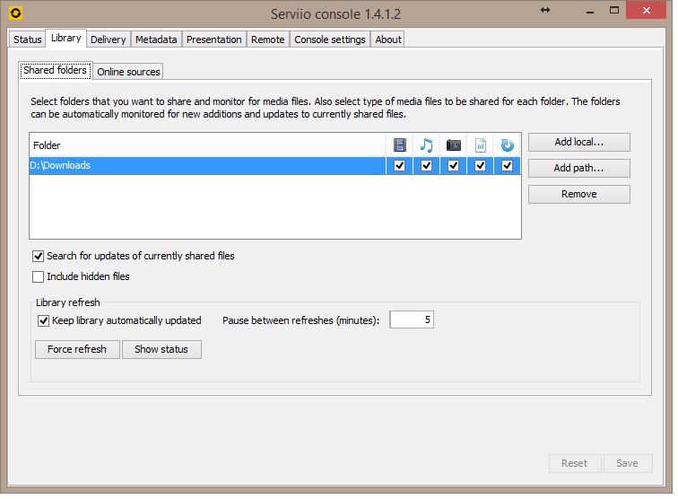

hi all,
i have an issue that appeared after i installed pro license.
my library is not updating automatically. if i use force option all is fine. i set auto update to 5 min. if i check the log file i can not see the thread for update, i see only when i manually update. thanks for any inputs.

Please see attached a print screen with my settings and also below the output from my log . As u can see in the log between 18 and 19, i had no check for the updates of my folder. The updated triggered only when i used Force Refresh option.
2014-10-18 15:17:08,296 INFO [LibraryUpdatesCheckerThread] Started looking for updates to currently shared files
2014-10-18 15:17:08,296 INFO [PlaylistMaintainerThread] Started looking playlist changes
2014-10-18 15:17:08,297 INFO [LibraryUpdatesCheckerThread] Removing 'Deadly.Code.2013.720p.WEB-DL.XviD.AC3-CzT' (D:\Downloads\Deadly.Code.2013.720p.WEB-DL.XviD.AC3-CzT\Deadly.Code.2013.720p.WEB-DL.XviD.AC3-CzT.mkv) from Library
2014-10-19 12:48:42,632 INFO [LibraryAdditionsCheckerThread] Finished looking for newly added files
2014-10-19 12:48:42,733 INFO [LibraryUpdatesCheckerThread] Finished looking for updates to currently shared files
2014-10-19 12:48:42,833 INFO [LibraryAdditionsCheckerThread] Started looking for newly added files
2014-10-19 12:48:42,833 INFO [LibraryUpdatesCheckerThread] Started looking for updates to currently shared files
2014-10-19 12:48:42,834 INFO [LibraryUpdatesCheckerThread] Removing 'Boardwalk.Empire.S05E06.720p.HDTV.x264-CzT' (D:\Downloads\Boardwalk.Empire.S05E06.720p.HDTV.x264-CzT\Boardwalk.Empire.S05E06.720p.HDTV.x264-CzT.mkv) from Library
2014-10-19 12:48:42,912 INFO [LibraryAdditionsCheckerThread] Added file 'Arrow.S03E01.720p.HDTV.X264-CzT.mkv' (title: Arrow.S03E01.720p.HDTV.X264-CzT) to Library
2014-10-19 12:48:42,979 INFO [LibraryAdditionsCheckerThread] Added file 'Arrow.S03E02.720p.HDTV.X264-CzT.mkv' (title: Arrow.S03E02.720p.HDTV.X264-CzT) to Library
Post Sun Oct 19, 2014 3:21 pm
Re: Library is not updating automatically
So it is not related to the Pro license as it's still the same code.
I don't see anything suspicious in the log, but can see the behaviour you're describing (file removal is not detected, right?). not sure what's happening, maybe a detailed log would help.

Well.... to be honest not very sure if this was working in demo period .... i activated the debug level, but i can not see anything strange....what i saw in my case was that the library refresh but i could not tell after what period.
The period that i set in the console " pause between refreshes" does not do the trick for me .
I want to ask u ... what should be the normal behavior of this :
from x minutes set in pause between refreshes, i should see in the log file a line that will tell me that the library is refreshed ? or
the log information only appears once the library is updated ?
Thanks for the info
Post Fri Oct 24, 2014 5:48 pm
You should see a (debug) line saying it's looking for new / updated files
