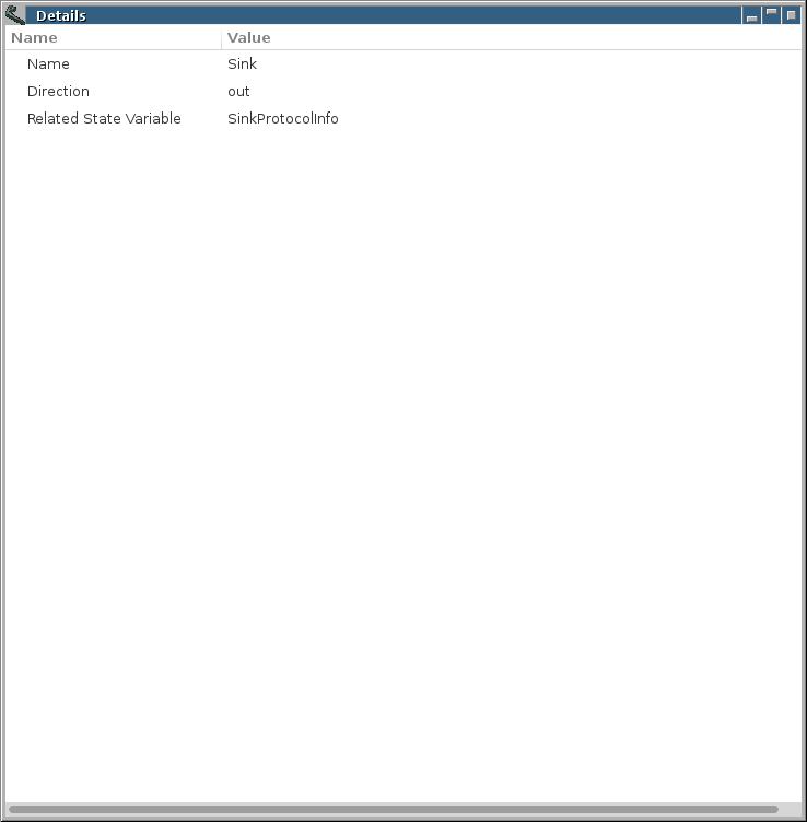

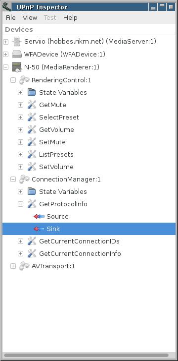

There is no entry for the N-50 in serviio, althought the generic one seems to work fine, and the Intel utility mentioned to get that data is a windoze thing and the msi doesn't install with wine. There is a linux equivalent in 'upnp-inspector' and there is a lot of info there, but the field mentioned in the sticky post 'getProtocolInfo--Sink' doesn't seem to have anything useful. Can anyone give me an idea of what is needed for the device setting?
thanks,
