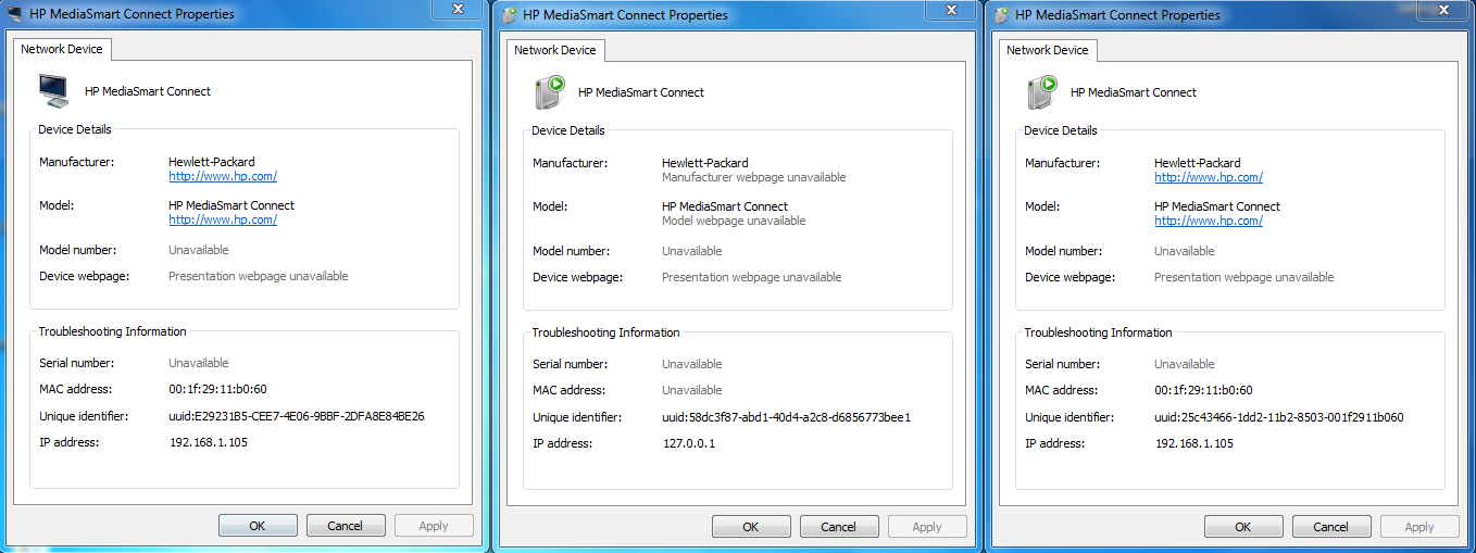

HP MediaSmart 1.PNG (130.21 KiB) Viewed 15529 times
Here's a Snip of the property windows for all 3 devices shown in "Network"
Post Sun Apr 13, 2014 9:48 pm
Re: Problem with dual function device
So Serviio only allows one renderer per IP, so your 2 devices will override each other as they advertise themselves to Serviio. Not sure if there could be some confusion then.
58dc3f87-abd1-40d4-a2c8-d6856773bee1 comes from .150 IP address, 25c43466-1dd2-11b2-8503-001f2911b060 comes from .105.
Also, the renderer has Limited access group - it should not matter, but try to set it to No Restriction (right click on the renderer in the console).

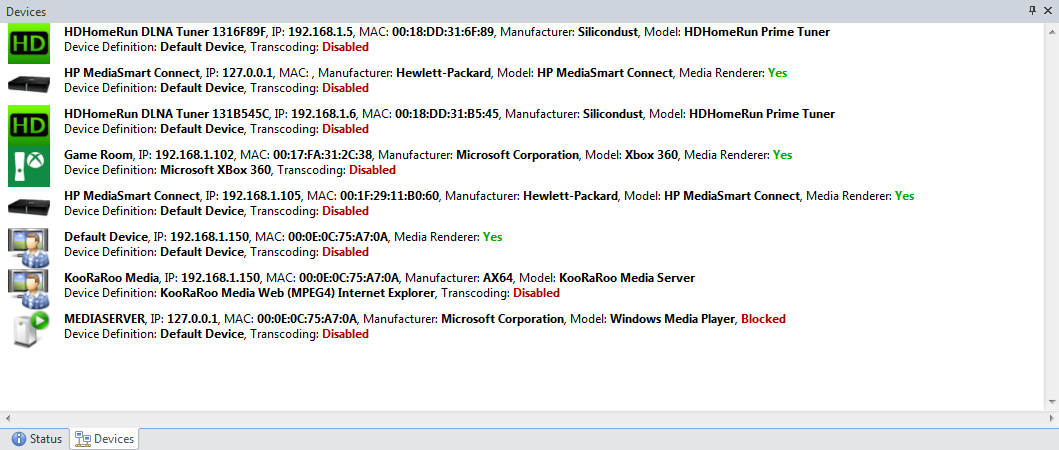

Here's what another DLNA server picksup, and it picks the correct device.PNG
Here's what another DLNA server picksup, and it picks the correct device.PNG (70.86 KiB) Viewed 15497 times
Nothing?
How to submit a bug?
This is definitely a bug!
Every other DLNA Server Software I have tried has no problem with communicating correctly with my device (Tried 4 others).
Code needs debugging, some how the loop back uuid is getting chosen, which would just send it back to my pc.
There's the reason there's no further traffic.
