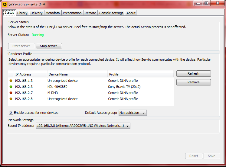

I have a SONY Bravia HX850. Serviio works just fine for me.
The problem is that when I add subtitles while streaming the movies to my SONY TV, the video shutters.
Without subtitles, all movies just work along fine.
Shuttering/ hanging of the videos while using subtitles is a major issue. What to do to solve this problem?
