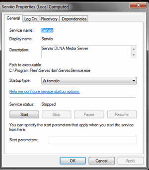

After the new 1.3.1 update. My Serviio Server doesn't start any longer, even after I manually start its service.
It just shuts itself off. I looked at the log file and the only error i see is a java error plus a disk cache error too.
Here's the log and a lil gif animation of my starting Serviio
and then when it just shuts-off.
Also I've uninstalled serviio and reinstalled it, yet nothing worked.
Thank you!
