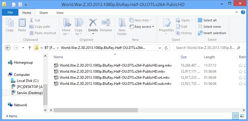

Please see below the screen capture showing the incorrect length and also incorrect file size when browsing the files via Serviio!

If Serviio transcodes the file (eg because the embedded subtitle has been found and burn-in is required), it will send a very large file size, so maybe it's this case and the TV retrieves the duration from the file size.
FFMpeg finds the correct duration, so Serviio should too (and it does for the other 3 files).
Duration: 01:56:04.75,
Try to disable embedded subtitles and/or burned in subs setting.

Thanks for your reply. I disable transcoding and subtitles and restart the server and serviio service. After that, the file size and duration is back to normal.
Furthermore, I found that this problem exists only on 3D movies (H-SBS or H-OU). (Maybe it is not right, but the errors in duration are on 2 3D movies I recently merged. And there is no problem for 2D movies with multiple subtitles.)
