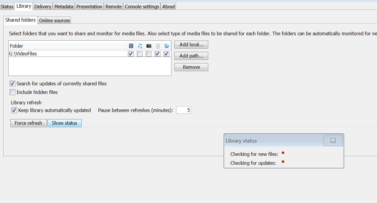

OK, So I setup everything as best as I could.. I can see the server on my TV and on the Web console page.. My setup is this..
Main Folder - G:\VideoFiles
Subfolders - G:\VideoFiles\Movies G:\VideoFiles\TVShows G:\VideoFiles\Cartoons G:\VideoFiles\Misc
Each Subfolder may contain a few subfolders also (TV Show Name, Movie Groups, etc..)

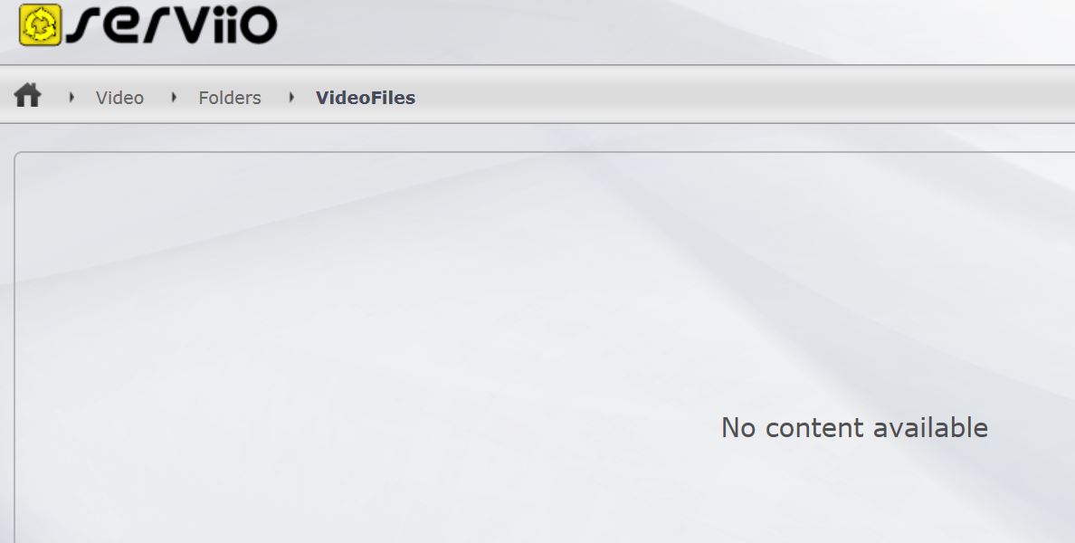

This is a Windows installation, and seems to be running fine. I can see the main folder I added (G:\VideoFiles\) but cannot see any subfolders, nor can I see any video files. I tried adding one of ths Subfolders to the program library also, but no luck..
When I check the library status, it shows a red dot..
I have been messing with this for hours over the past few days. I have uninstalled and reinstalled.. When I check the log file for serviio it looks normal, with no errors that I can find.. Any thought or help would be very much appreciated.. I can use the normal windows DLNA server, but would much prefer to use this highly rated server software!
