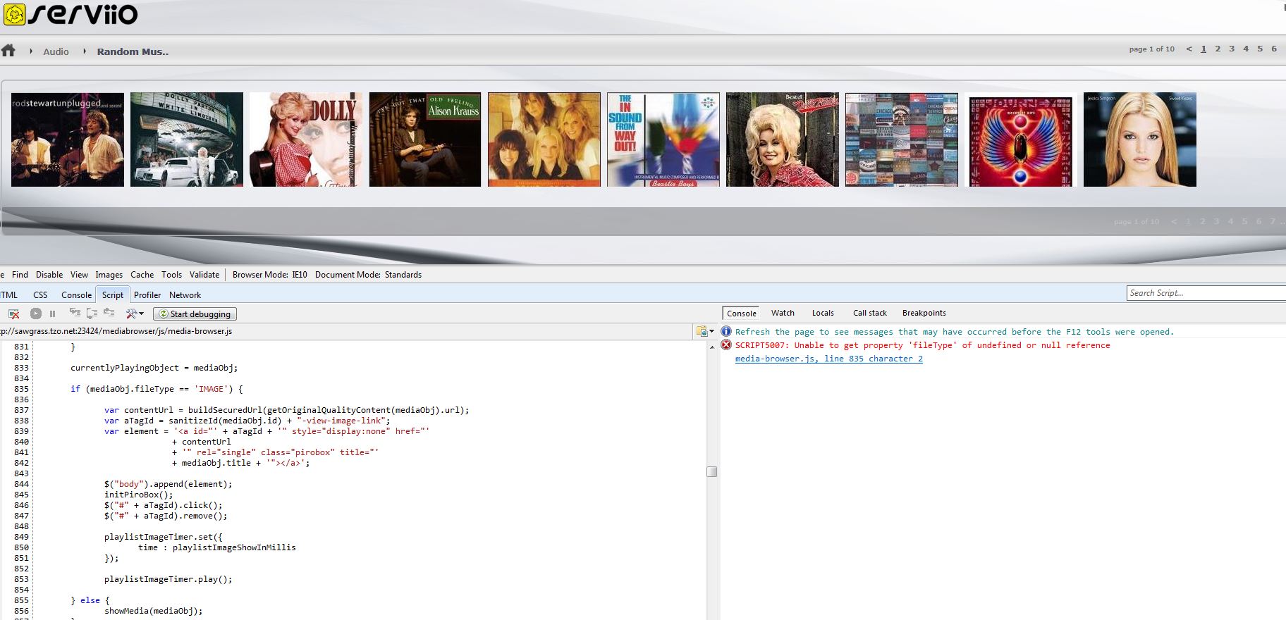

I have had a little more time and decided to make another attempt. Completely fresh install of 1.3.1. Attempting to use the random music feature I get a browser error in the web page. The errors from IE9 IE10 and the latest Chrome all reference the same line. The error references "Unable to get property type 'fileType' of undefined or null reference". After selecting a track to begin playback Flow Player opens and then immediately closes with the referenced error posted.
I have attached a developer tools snapshot of the error generated in IE10. Again the same reference is generated in IE9 and Chrome.
Any Thoughts?

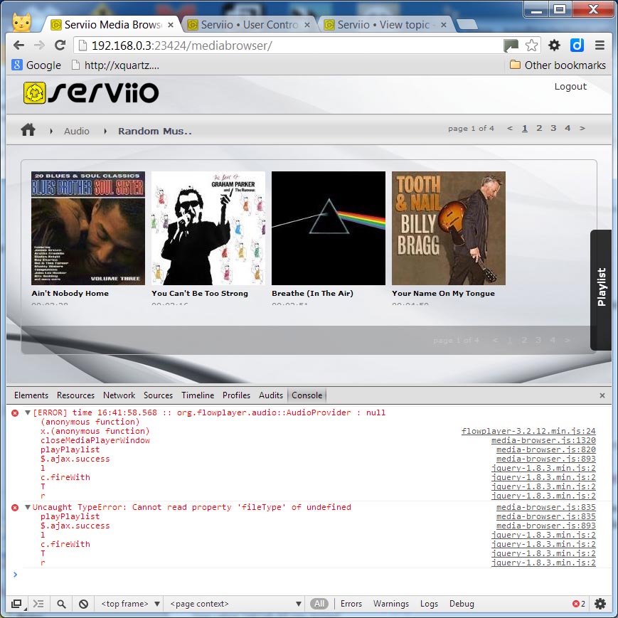

tonybayley
Joined: Sat Sep 07, 2013 3:20 pm
Post Sat Sep 07, 2013 4:31 pm
Re: v1.3 Random Music issue
I have the same issue when using the Serviio Pro v1.3.1 media browser app with Chrome v28.0. Whenever I play a "Random Music" track, it stops playing after about 1 second. I have attached the view of Chrome's JavaScript console just after the track stops playing.
Chrome JavaScript console showing error after Random Music stops playing
The bug only affects the Serviio media browser app - Random Music plays OK on my hardware internet radio (Tangent Quattro). Let me know if you want me to provide any other information to help you debug the issue.
