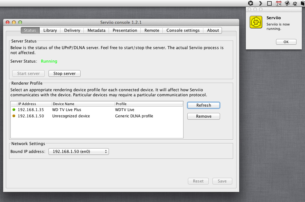

I have posted my log. I have never had that message before. It continuously repeats. I somehow think it is related to the JAVA update, as Biker says. Java update was not applied until after the official 10.8.4 was out. That was when I noticed the problem.
I have started and restarted in multiple combinations, manual and automatic addresses, clearing caches, everything I could think of.
My log always indicates that it sees and is talking to the WDTV box but I still get the "Could not advertise the device on any available NIC" right after.
Last night I updated to 10.8.5 beta and have the same exact problem, no change.
I also notice in the Serviio Console I still have the reddish yellow indicator with the unrecognized device message that started back when I updated to Serviio 1.2. (see attached) Since I was always having perfect video serving I did not worry about it. Now I'm concerned again.
Also, why is there no Mac OS setting in the device dropdown ? Have us Mac users just been lucky that everything has worked up until now ?
I am really concerned now as I have Serviio running on several of my client's networks and they are all Mac users. No complaints as yet as they are all using NAS devices. Those are having a different set of problems but they are being managed for now.
Serviio is currently useless to me in this state. I have never received any messages from fellow Mac users here (except for Biker). I have asked for a confirmation of operation problems I was having several times before to no response so I guess everyone here is using Windows.
This really sucks since the reason I found Serviio was the exact same failure of PLEX. They have the exact same DLNA / WDTV problem over several versions (still happens with the latest version). I called their attention to it many times and so have others. PLEX geniuses have chosen to ignore it as does WD.
I think PLEX prefers their customers use "official" PLEX devices rather than DLNA. I hope that doesn't happen here.
Thanks for any help you can provide. I do not have the knowledge or time to learn and apply the deeper details of how Serviio works to solve my problem.
Regards
Serviio screen.jpg (164.24 KiB) Viewed 22736 times
