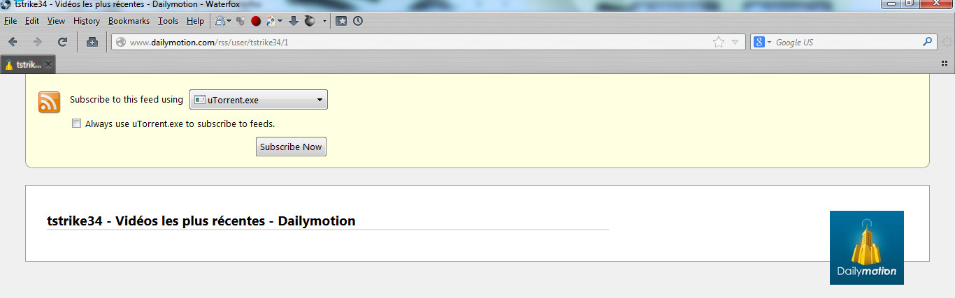

tstrike wrote:Ok Petr...
For me, some streams work... My own personal one does not
http://dailymotion.com/rss/user/tstrike34/1
*scratches head*
I'm confused : when I search on DM with your user id (tstrike34)
I get
Résultats de recherche pour tstrike34
"Woops! Pas de vidéos disponibles pour cette recherche. "
(Search results for tstrike34
No videos available for this search)
It should include videos I have saved in my favorites list.

Well, when I type http://www.dailymotion.com/rss/user/tstrike34/1 in my browser I get this (see screen capture).
What could I say ?

jdegreef wrote:
tstrike wrote:So ... any merit to my observations?
What could I say ?
I have no videos there...
I have built playlists from other videos.
With that said, please see my comments related to your earlier query. I believe both you and Petr have valid points regarding the delay in reading the metadata from the Dailymotion videos.
