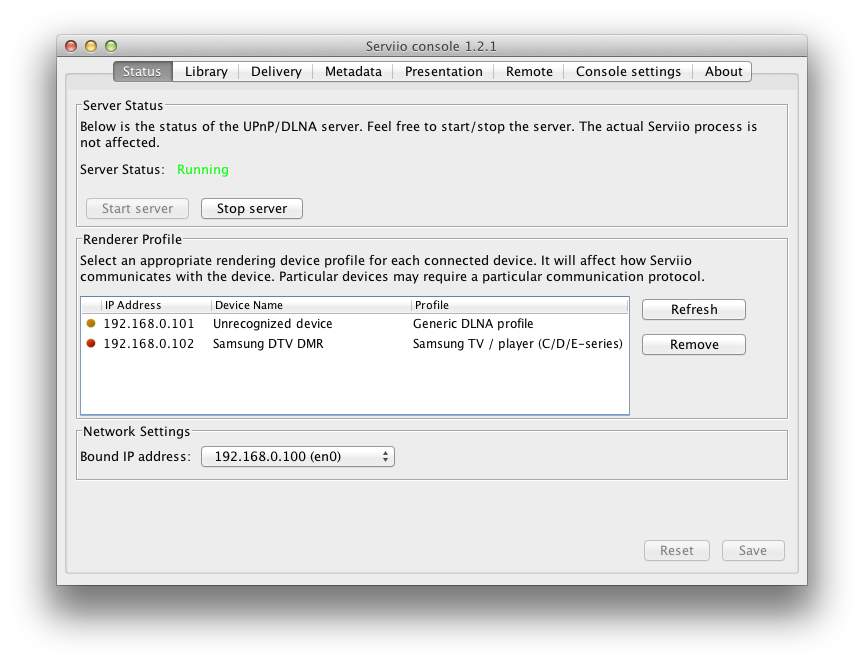

Can you write us what have you tested already? What is you OSX version, what is your Java 6 version? Do you see your TV in Serviio-Console application (Status tab)?

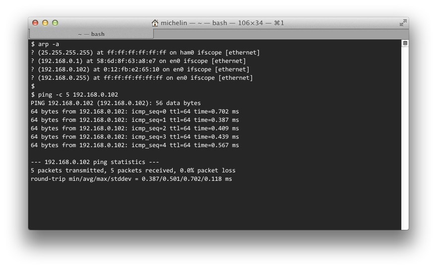

So it seems like some other issue. I would try to diagnose if TV is reachable.
You can see on snapshots from my Mac, that I can ping Samsung TV and get response, so I guess your Sharp should be also pingable...
