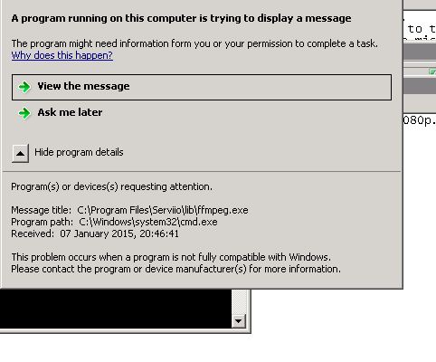

Hi DLNA master well it seems I have gone a bit further this time, I now get an error message that the file is incompatible
Error 1.JPG (40.68 KiB) Viewed 15414 times
Post Wed Jan 07, 2015 9:20 pm
Re: Help
Wow, that's a wild one! I've seen that type of box appear before, but not using FFMPEG. And this error is Windows based, saying it has an issue trying to run FFMPEG. It has nothing to do with the video file you are trying to test. Have no clue why it would error, as I never have a problem. It is possible that you need to run it as Administrator. You can do that by right-clicking the CMD applet and select "Run as Administrator".
Let's try something easier. Download MediaInfo (http://mediaarea.net/en/MediaInfo). Install this, and then you can simply right click on a media file and view the information about the file. FFMPEG sometimes includes more information, but MediaInfo is easier to use. ;)

That file you just posted the info for has video and audio codecs that are playable on most devices, AVC video and AAC audio. That's likely why it plays fine. Compared to the original one you posted, both the video and audio codecs are completely different animals. :D The first file has AC-3 audio, and that should play on anything, so the problem has to be the video codec.
When no playable files are listed, that usually means that for some reason Serviio doesn't recognize anything in that folder as playable on your device. One cause might be that your device has changed its IP address, and now has an incorrect profile assigned to it. Check the status tab in the Serviio console and make sure your playback device IP address matches the one shown in the console.
Any time you make a change to the profiles.xml file, the Serviio background process must be stopped and restarted. If you know how to restart a service on your computer, that's faster than a reboot. However, if you are unsure about it, a reboot is never bad form. As to if it will resolve your issues, that depends of if the changes made to the profiles file make any difference.
Post Mon Jan 12, 2015 3:25 am
Re: Help
From the OP it appears that ffmpeg was not extracting the information Serviio needs for the media file - when this happens Serviio will determine that the file is not a valid media file, and will not add it to the library. If its not added to the library you wont see it on your TV (or via Mediabrowser).
Can you please post ffmpeg -i information for one of the files in the error list: eg. S:\serviio\Finding.Nemo.2003.1080p.BluRay\RARBG.COM.mp4 - its strange because ffmpeg seems to be working correctly.
On doing a Force Refresh do you still get these error messages in the log?
If so, check file permissions on the files to ensure that the user that Serviio logs in as has read access to the file. Try moving the file to folder on a different drive and sharing that folder - this will help define whether its a permissions issue or a Serviio/ffmpeg issue.
For the second issue (all files disappearing) you appear to have your media files on a remote drive. I suspect the reason that the files disappeared is that the drive was not mounted (or otherwise not accessible) at the time of the library refresh. Serviio will then detect that the files no longer exist, and remove them from the library. This can sometimes happen on startup where the drive takes time to mount.
This behaviour has been fixed in the next release - due out shortly. In the meantime, make sure the drive is available and press Force Refresh. If Force Refresh is still greyed out, check that all folders are still in the library. Is Save also greyed out, if not press Save or the other button (sorry not in front of Serviio at the moment).
