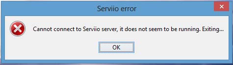

I have the same problem on Windows 8 x64.
The programs installs, starts after the first reboot and no longer starts after following reboots. Sometimes it randomly starts the next day(!)
Both x32 and x64 Javas installed. I try to manually start the server before starting the console - does not help.

The problem is the same - does the developer have to say anything about the problem? Removed the program, reinstalled, worked for one day and then jumped back to non-working condition with the same message.
Post Tue May 13, 2014 6:11 pm
Re: Console doesn't launch
Either the server doesn't start (check the log), or the console starts before the server starts. you can try to remove the console from the Startup menu, so that it doesn't start on boot and run it manually only when you need it
