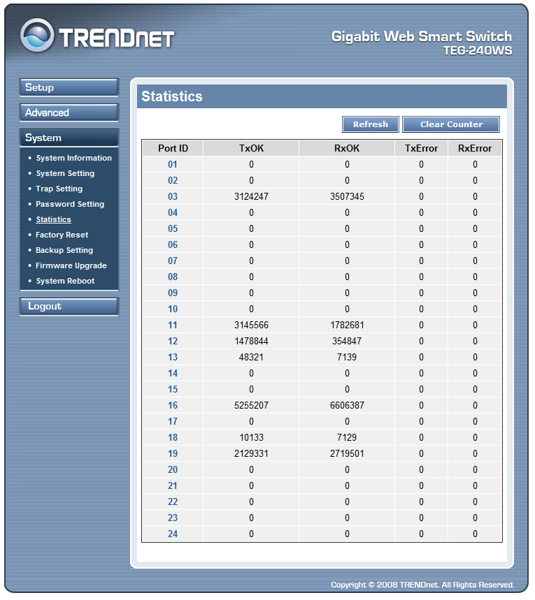

Regarding the network. The devices are connected to a Trendnet TEG-240WS switch. See attached statistics. No Rx/Tx errors. All local network load is put on the switch, and the internet gateway / router connected to port 3 is only handling DHCP and internet data.

Switch statistics
