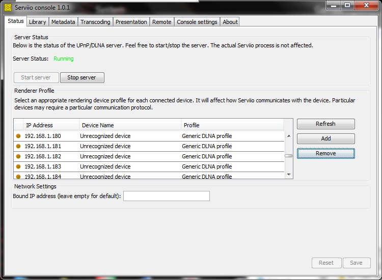

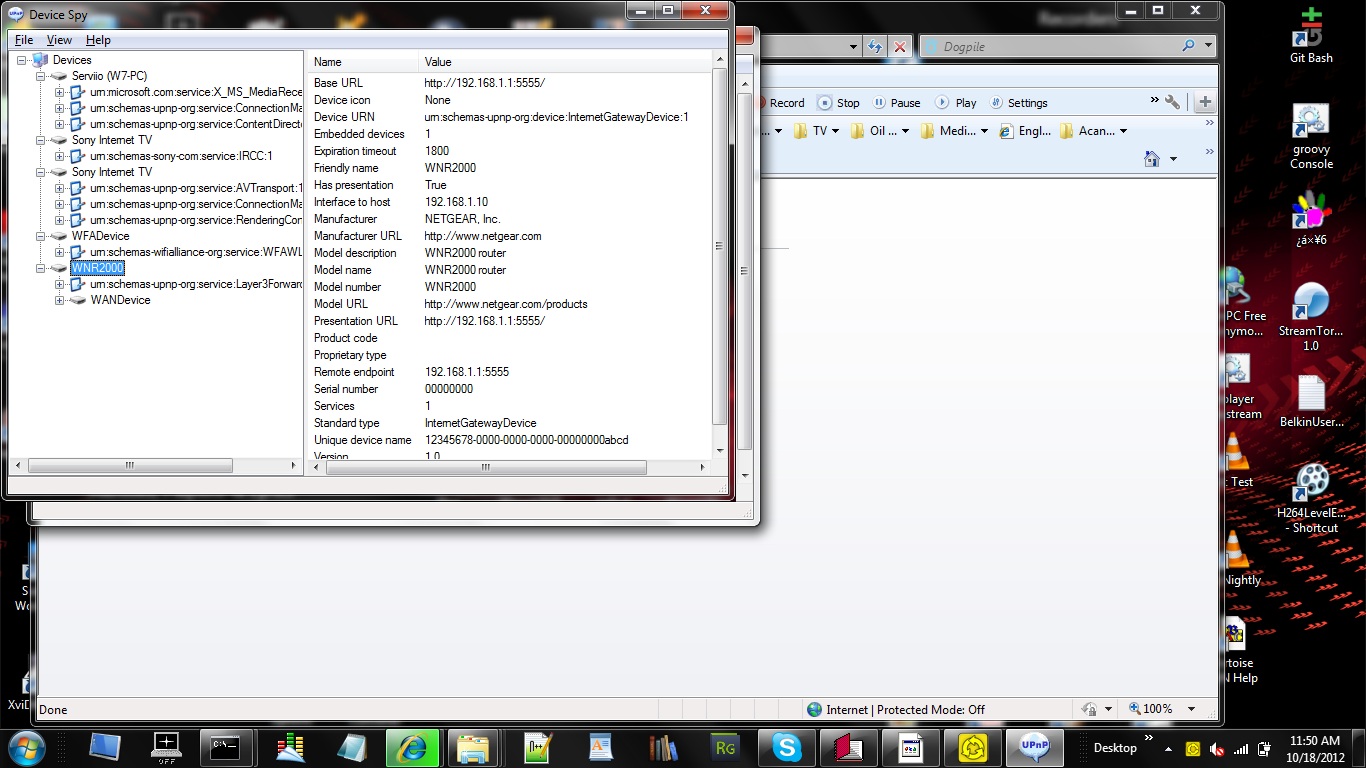

Visiting my daughters home, and Serviio now shows devices 192.168.1.2 thru 192.168.1.184 in console with generic profile. Reset button does nothing and only choice seems to be to do 180+ separate deletes to clear them. How does one reset the device list?
See attached console and device Spy shots

You have to do it one by one. Refresh would get a new state, but only the devices that can be found by the UPnP Search method (and can be identified by their UUID). For other devices we just create a new renderer in the table when the IP address changes.

Sorry but I do not understand. There are only a few real devices as device spy shows, so how can Serviio generate renderers for all these hundreds of non existant devices.
