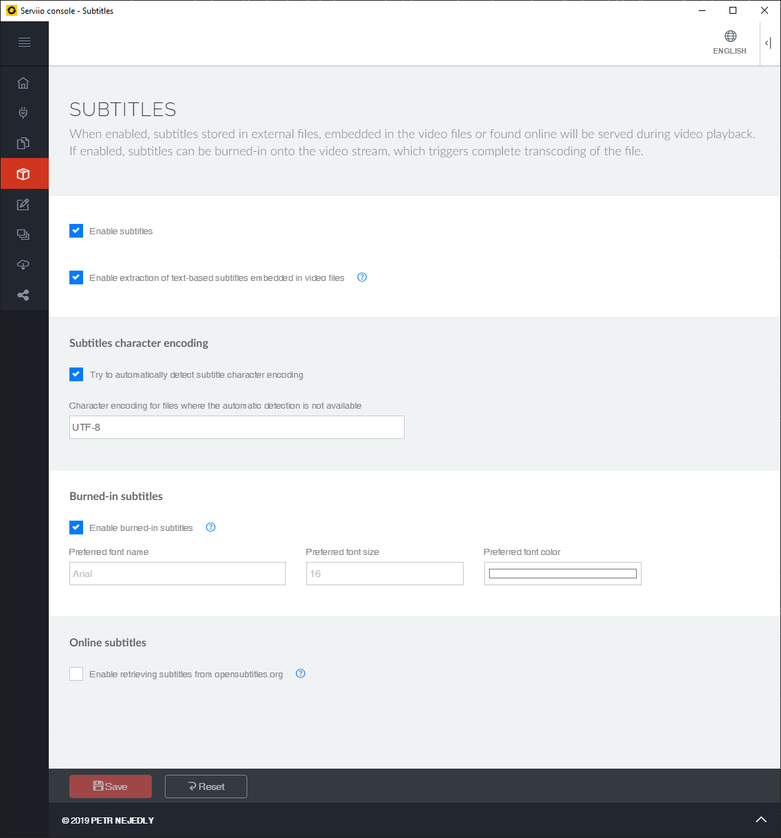

so if you play file with subtitles, can you look in the transcoding folder of Serviio (defined on the Transcoding tab in the console). There should be some folders and one of the will include the srt file extracted from the MKV. See if it's complete.
Also please attach a screenshot of your Subtitles Serviio console tab.
