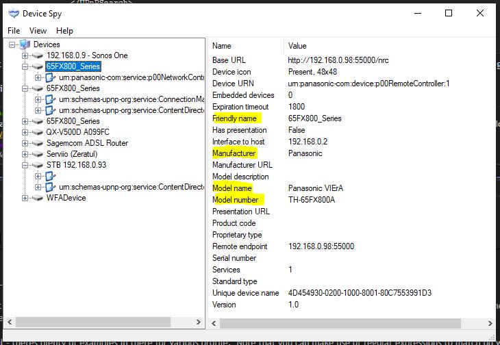

To find what string to put into the detection block use Intel UPnP tools and run Device Spy (with your Kindle running and connected to your network). IF the Kindle identifies itself then you will see it under the Devices:

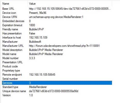

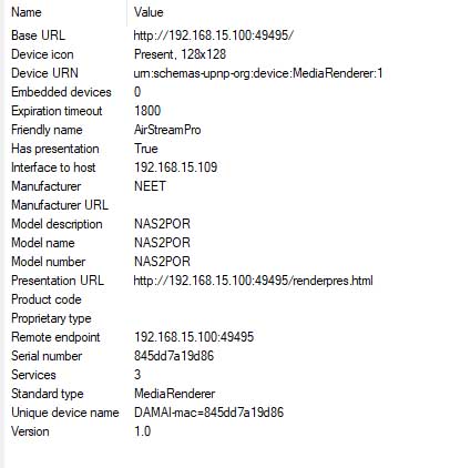

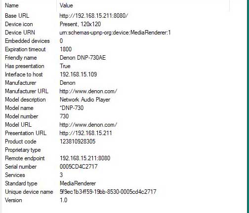

I did download UPnP tools and Device spy (as you suggested).
The results for three devices are attached.
I am trying to do two things:-
1. Initially I was trying the ensure that my "Generic HD Profile" in my user-profiles.xml file is used by Kindle 7 HDX which runs BubbleUpnP and does not have a fixed IP.
Hence my original suggestion of an alternative default profile.
The only change in the generic profile was ThumbNail HD not DLNA for quality artwork.
2. Additionally I added an audio transcode in <OnlineTranscoding> to detect ogg files (which would not play) and match them with LPCM which works fine.
Hence Denon and AirstreamPro devices.

Neet AirstreamPro
Denon DNP-730AE streamer
BubbleUPnP on Kindle 7
