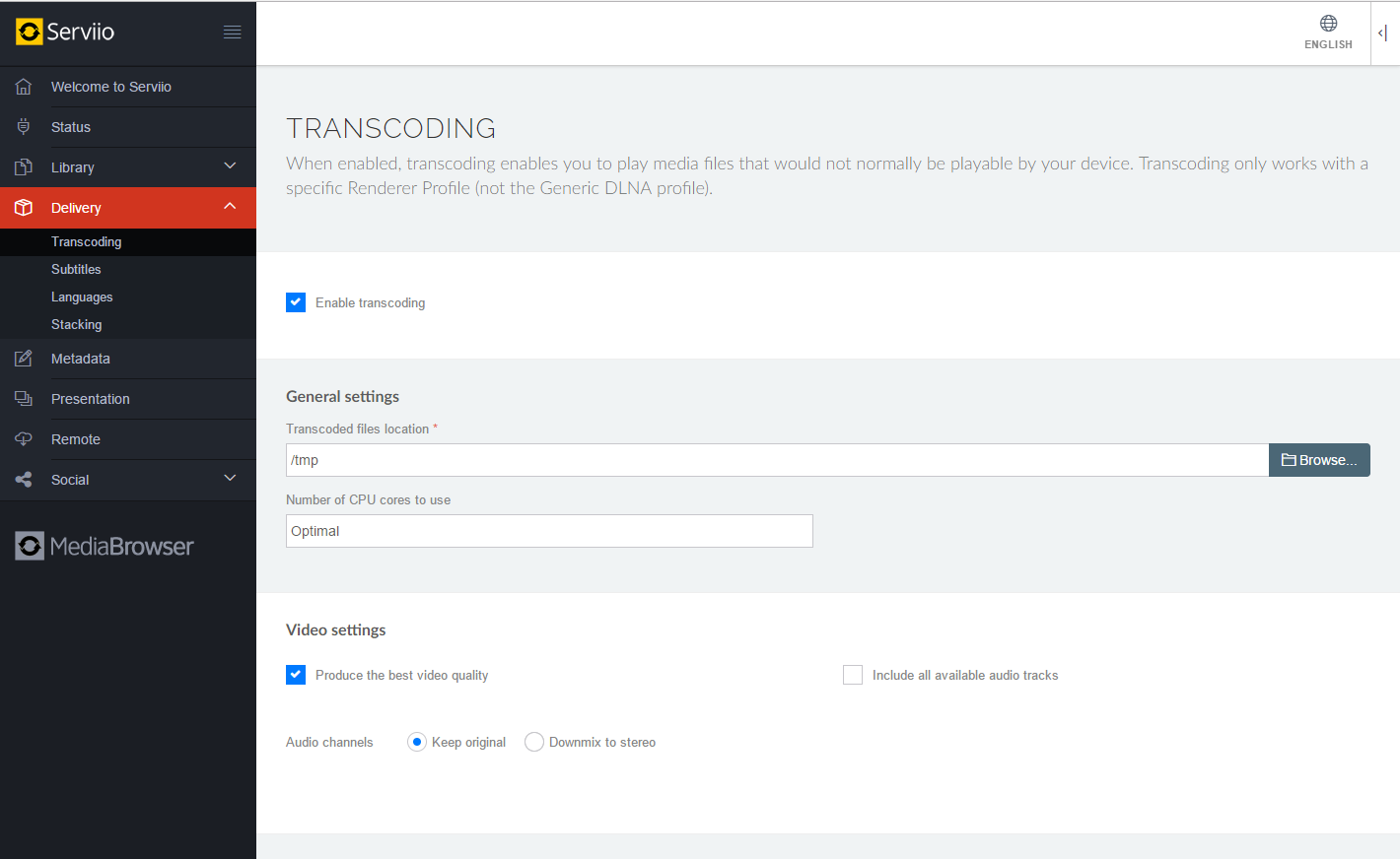

Thanks for the reply, but this is what the delivery->transcoding menu looks like for me right now:
Post Mon May 22, 2017 12:06 pm
Re: How to control the transcoding profile for the web playe
The setting you seek is on the "Remote" tab :)
