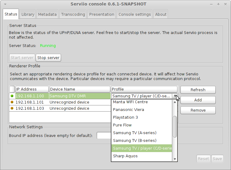

DLNA has been distorted by many manufactures to make it so their equipment will work best only with their other equipment...prime example is the XBOX 360 which works well with Windows Media content but is a dog with every other DLNA codec spec. A Playstation3 is the most versatile choice as codecs go and will work with Serviio if the connections are really good...it is quite complicated to get the Playstation to work perfectly with a server but it is entirely possible because all you have to do is allow your server to push content to the Playstation with the Settings menu then make sure the profile is selected correctly in the console settings for the renderer.
set renderer choice here if device is not correctly set automatically
Screenshot-Serviio console 0.6.1-SNAPSHOT.png (68.45 KiB) Viewed 7737 times
Some DLNA enabled dvd/bd players can be the cheapest choice and some Samsung and Sonys are well supported and will work well. Check out this thread viewtopic.php?f=6&t=63 There is good info there about which devices work best and you can help by participating in the supported device discussion by describing what exactly is not working with Panasonic's TV DLNA ..
It helps if you turn on detailed logging and then post the log findings as Serviio tries to push content to the TV. Posts by Zip all include this link...about how to help out with device support. viewtopic.php?f=5&t=7
