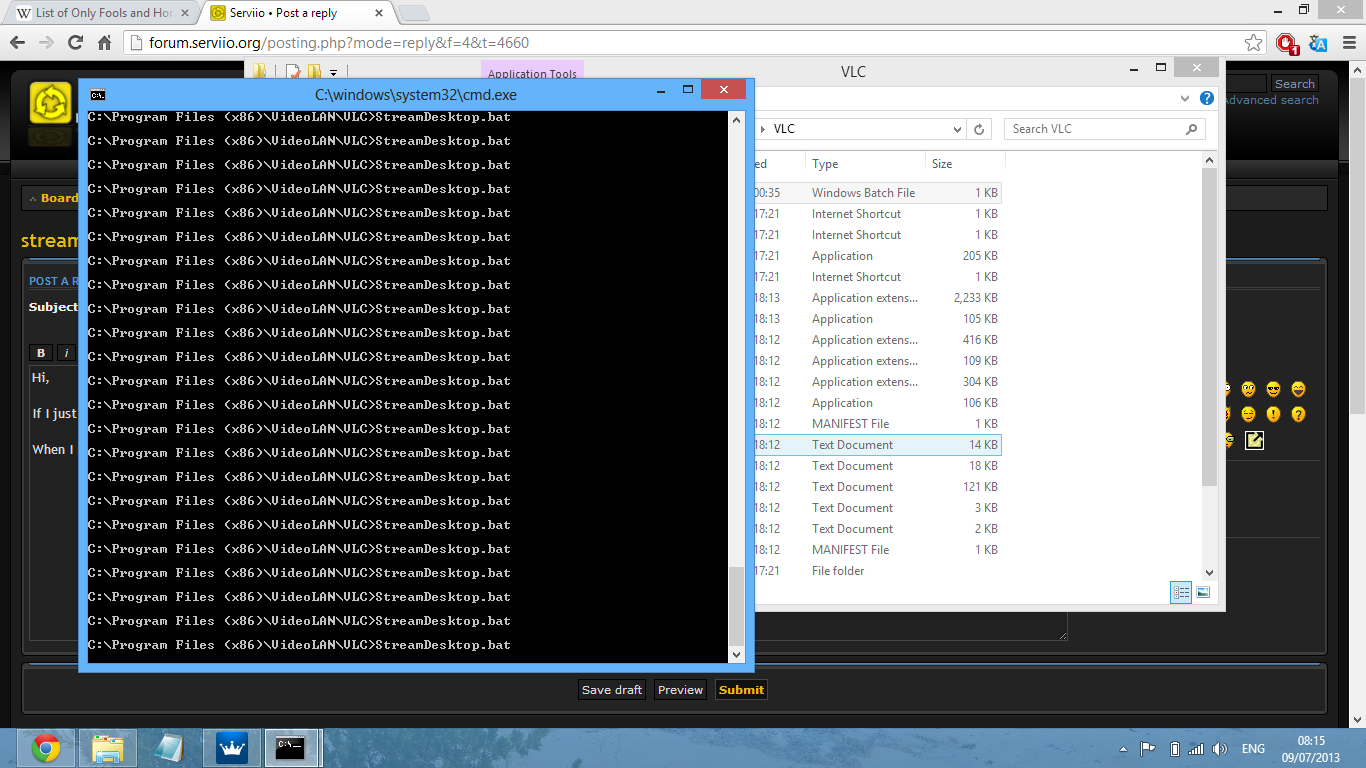

If I just open the command prompt from the start menu its set to C:\windows\system32> .
When I run the bat, I get C:\Program Files (x86)\videolan\vlc>streamdesktop.bat repeating indefinitely as per attachment.
Bat file is saved in VLC installation file (C:\Program Files (x86)\VideoLAN)
The address of the vlc.exe is C:\Program Files (x86)\VideoLAN\VLC
I get the same outcome if I save it on the desktop.
Thanks...
bat screen.png (198.92 KiB) Viewed 28860 times

I have no idea what you are doing. There is nothing in the bat that would change the default prompt, and you have not shown the command you are using to start the bat so you have something in the way that's doing that and causing your problem.

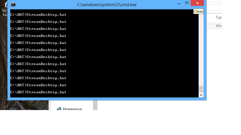

After some messing about I now have the command prompt of C:\Users\Dan Price>
But when I click my bat file, I get one of 2 outcomes. If I leave streamdesktop.bat in the bat file I get the repeating screen as mentioned. If I remove it I get c:\program is not recognised as a internal or external command, operable program or batch file.
I must be close to success, but I just cant see it...
I should add, I am on Windows 8, dont know if this could effect it.
EDIT - - if I move the bat file to c:\bat as you do I get a similar outcome as last mentioned. See screenshot
Post Tue Jul 09, 2013 7:54 pm
Re: streaming desk top to tv
Per the wiki, the bat file starts at the @echo off line and the vlc command is in quotes. Starting with the streamdesktop.bat line it just keeps executing itself.
